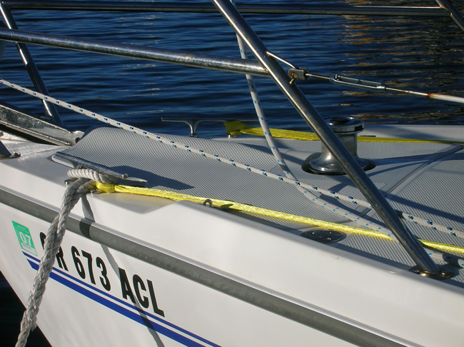

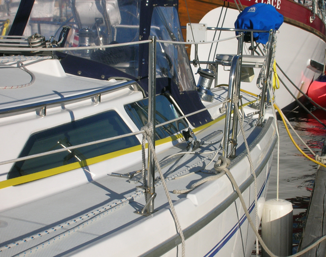

I haven't installed padeyes, but I do run webbed jacklines from bow to stern, inside the shrouds, when going offshore. See photos below.
We, too, use the existing cleats with flat webbing. I tie a bowline through the hole in the bow cleat and just do a "standard" wrap of the aft cleat with the webbing.
We use flat webbing from the port bow cleat inside the shrouds to the stbd midship cleat (moved all the way aft), and opposite for the other side.
The crossing at the bow is my attempt to keep the jackline nearer the centerline of the boat, which probably has only a small effect. The midship cleat when full aft is far enough to get back into the cockpit where I have padeyes at the base of the companionway bridge deck. When at the helm, I clip in to substantial hard points by the railing.
