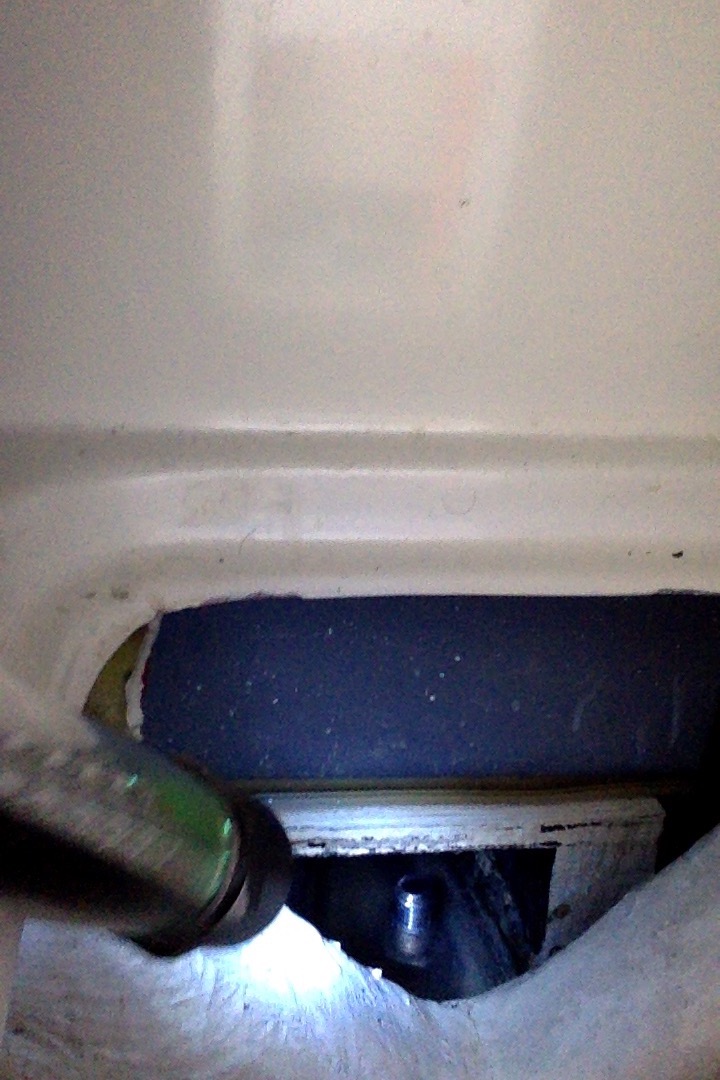

36-1985 does anyone know if there is a hidden keel bolt under the fuel tank. Stern of the bilge?

On my boat there are no "hidden" keel bolts aft of the bilge but there are some forward of the bilge around the mast step that can not be reached without taking up the cabin sole.

Thanks everyone, much appreciated. I've found a total of 9. One fore of the mast, two aft and the other 6 visible in the bilge but I heard a rumour there is one under the fuel tank aft of the bilge. I've decided to purchase a flexible camera and take a look before going further.

There are 10 keel bolts in total on Firefly and the hull is supposed to be identical to the '85.  4 pairs and one single in the narrow space fore of the mast step and another signle one in the center behind the aft-most perpendicular rib below the floorboards.  I can see this aft-most single bolt because the rib was cut down in a V-shape and glassed over by the factory.
See photo attached.  That's the bolt dead center, the V-cutaway at the bottom and the fuel tank on a plywood shelf above.  If you have no cut-away, versus removing the fuel tank and potentially having to cut a hole in the plywood to torque it, I don't think there would be any structural problem with using a reciprocating saw to cut a V as the factory did, then glass or epoxy it over, as long as the angle of your wrench could work in that tight space.

Kevin, thank you for all the details, this is very helpful. I found the bolt with my camera so I now know it exists. I will reinvestigate my options and see if it is possible to do what Firefly has. I’ll look for you on the water, next year, we come out tomorrow.

As the biggest issue with the '80s Catalinas was the 'smile' at the leading edge of the keel, which was repaired on SusieQ as I recall, I suspect that snugging up the 8 exposed bolts while on the hard is all you need do to be on the safe side.
