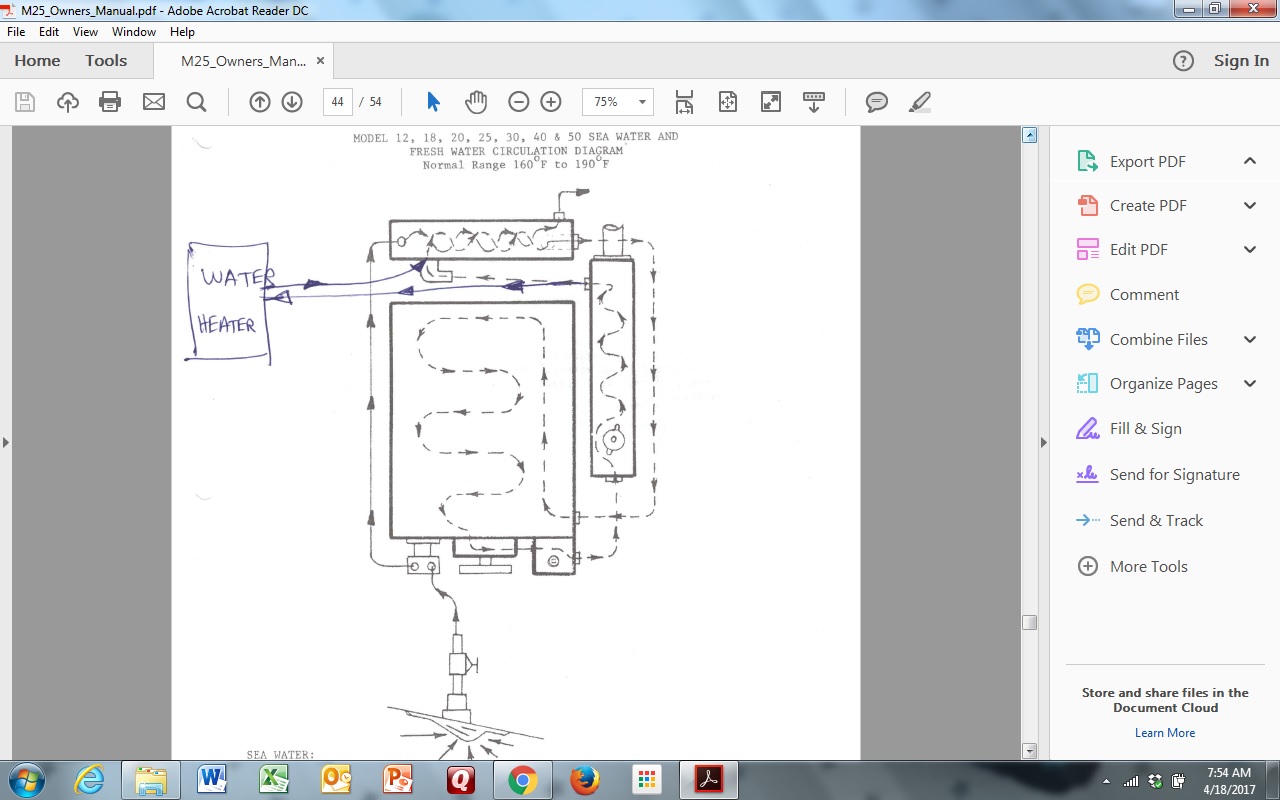

Roy,
I don't know why the M25 Owner's manual is not on the website, but here is a screen shot of how I plumbed the water heater after taking out all the extra hoses and fittings.  Hope this helps.
