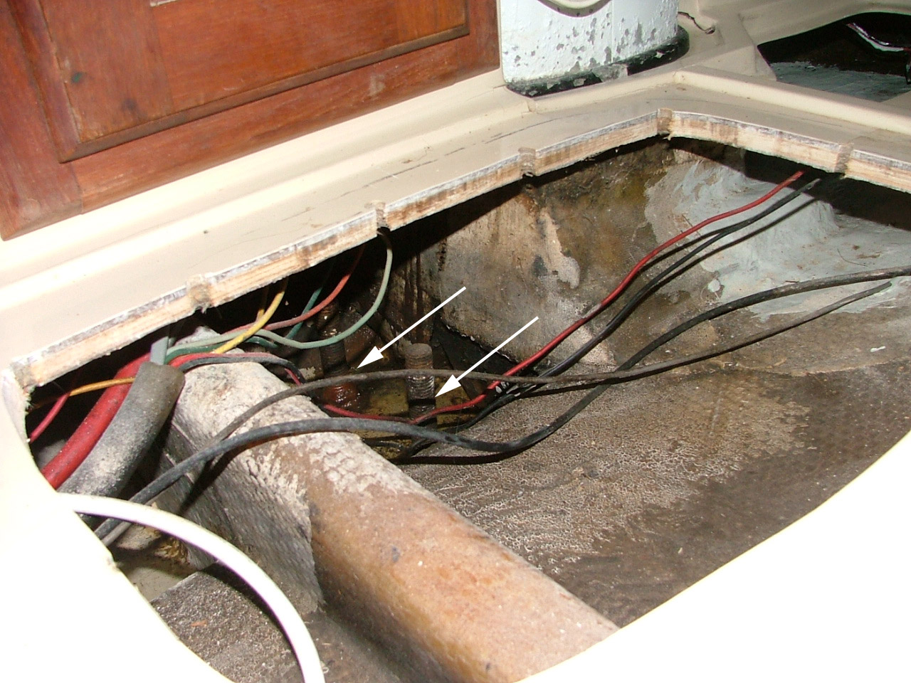

Rob Kyles's picture
Rob Kyles
Joined: 6/15/08
Posts: 172
We found one in front of the mast, two just behind the mast that were NOT visible until we cut away some of the cabin sole (see photo) and were somewhat corroded. You might see them with a light and a mirror from the little hatch in front of the mast...
Our mast step was rotten and had to be replaced :-(
