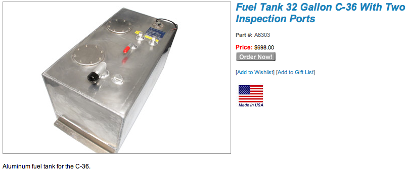

Just food for thought, but I'd spend time on your fuel system - especially on the interior condition of your diesel tank.
Plant growth, which grows in the tank and breaks loose in rough water, can and will clog filters thereby killing your engine.
When I bought my boat, I cut two holes - after draining the tank and vacuuming out the diesel fuel -  in the top of the fuel tank and clean the entire inside of the tank. It was a mess with algae growth; almost half and inch think.  I clean it all out. Made inspection plates and threaded hole the top of the tank, and installed the plates with pliable non-hardening sealant. No leaks as of yet.
I also replaced all the fuel lines and filters.
I motored 444nm without a hiccup from the engine.
Time and energy well spent.
The new tank supplied by Catalina Direct come with custom inspection ports all ready form the factory - and are USCG approved:
http://www.catalinadirect.com/index.cfm/product/2936_800/fuel-tank-32-ga...
Mitch
