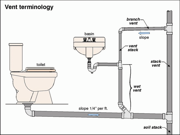

Here's a pic I found on the web that illustrates the vent concept. In the house it's basically the stack that goes through the roof.

Gary, I think that the purpose of the vent in a house is to allow sewer gases to escape, not to enhance the flow of the sewage...but then, I am only an amateur plumber. In any event, I doubt that such a vent would help drainage of the C36 sink drain. In our boats, the drain is only about two feet long. My theory: The drain hose is of a small diameter, so food particles and other crud can easily add even more resistance to the flow.
Jack, your idea sounds like a good one. Whatever grows on our hull also grows in the sink drain hose; then add to that a mixture of food particles and other crud.
Larry, I saw a demonstration on "Holmes on Homes" where he built a little sink with drain and a vent/stack. He blocked the vent and the sink drained slowly and gurgled. He filled it up again, unblocked the vent and the sink drained in a quarter of the time. Convinced me. I believe you're correct that the stack also vents sewer gas, but it also functions to improve draining of liquids.
