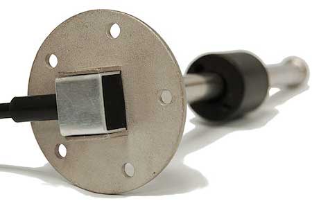

Inside the port lazarette there is an access cover. After removing you will find the fuel sender mounted on a 2 inch plate that is fastened with screws. Remove screws to see the fuel inside.
This is the sender unit that I recplaced my sender unit with from Catalina direct for C36   part number Z3529

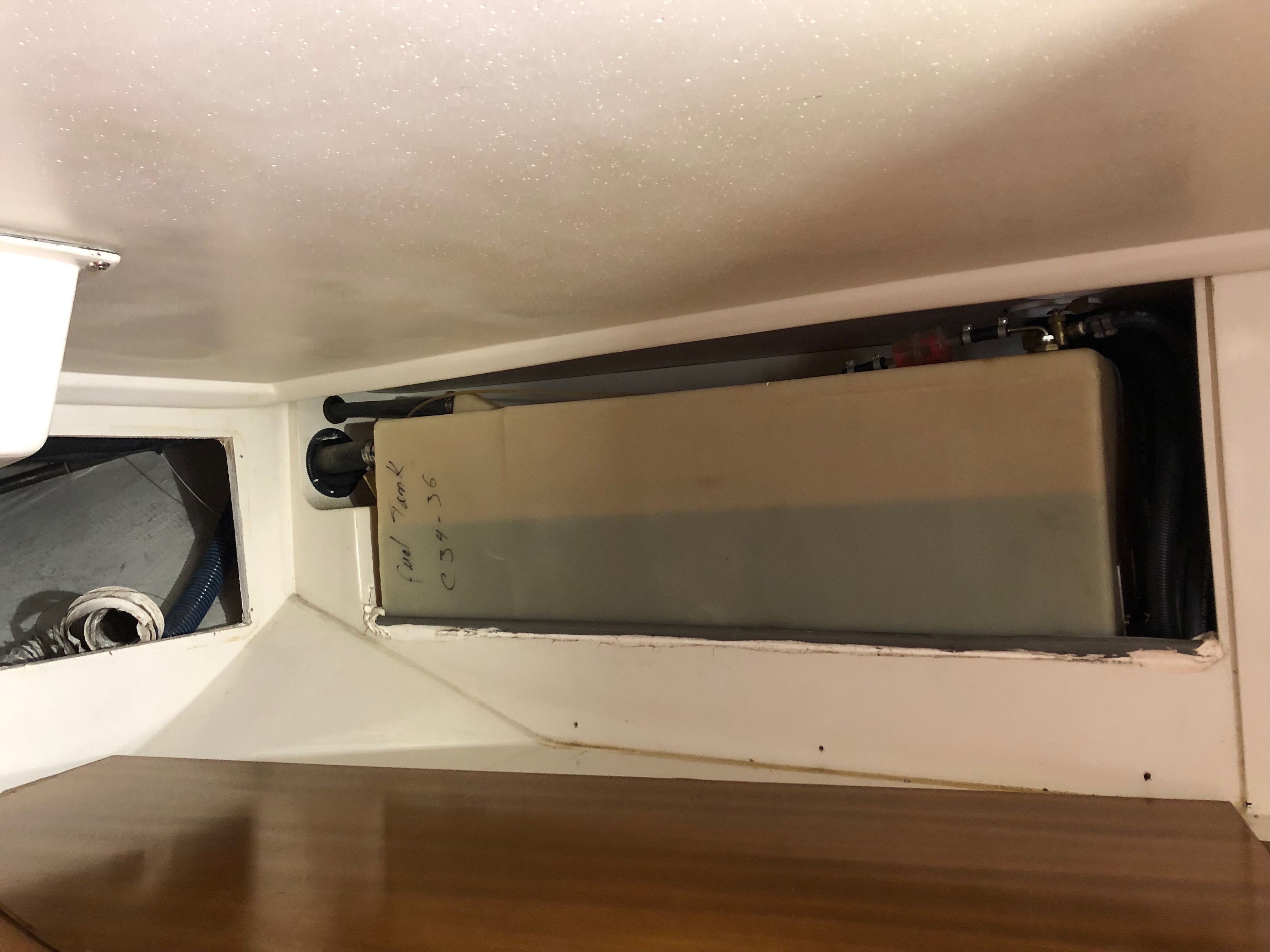

I believe you will have limited space to polish the tank from the top through the inspection cover in the PS-lazarette area. Maybe easier to remove the panel in the aft-cabin and slide the fuel tank out... (hope it is the same set-up as on our Catalina..)
Durk Nijdam
S/V "SILER"
Stavoren - Holland
Image icon IMG_3119.jpeg1.44 MB
