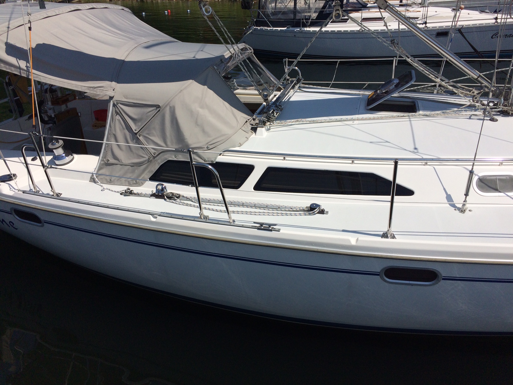

My wife and I just completed the replacement of the two stbd fixed cabin windows on our 2000 36 MKII. The originals crazed VERY badly on that side. While it was a challenging job, it's not beyond a reasonably competent owner.

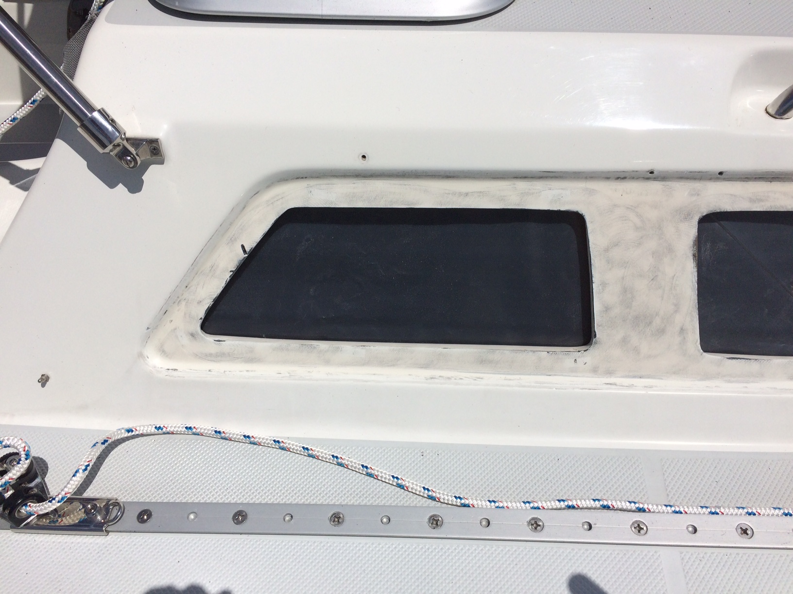

I used a fish fillet knife to cut the old ones loose. It ended up bent like a banana, but didn't break. We worked from both sides until we got an opening and then I inserted the fillet knife from the outside and finished the cutting.
A combination of paint scrapers and plastic scrapers Mark provided removed most of the old caulk, (Dow 795-black). This left some remainder that I got off easily with a brass brush chucked into a drill. I used a dust mask for this as it was a bit dusty.

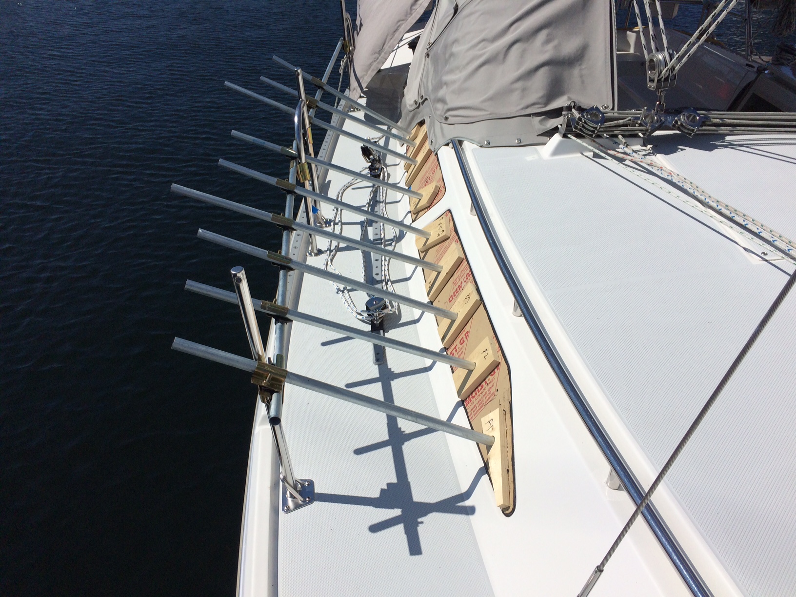

I decided to try EMT conduit clamped onto the stanchions as blocking while the windows "cured". I removed the clamp system on day 3.
It it came out very well. Here's a couple of pics. I didn't try to document the whole thing as Mark's photos are stellar!

Nice job!  I just replaced a couple of them on my mk1.5, not a fun job.  Yours look good as new!
