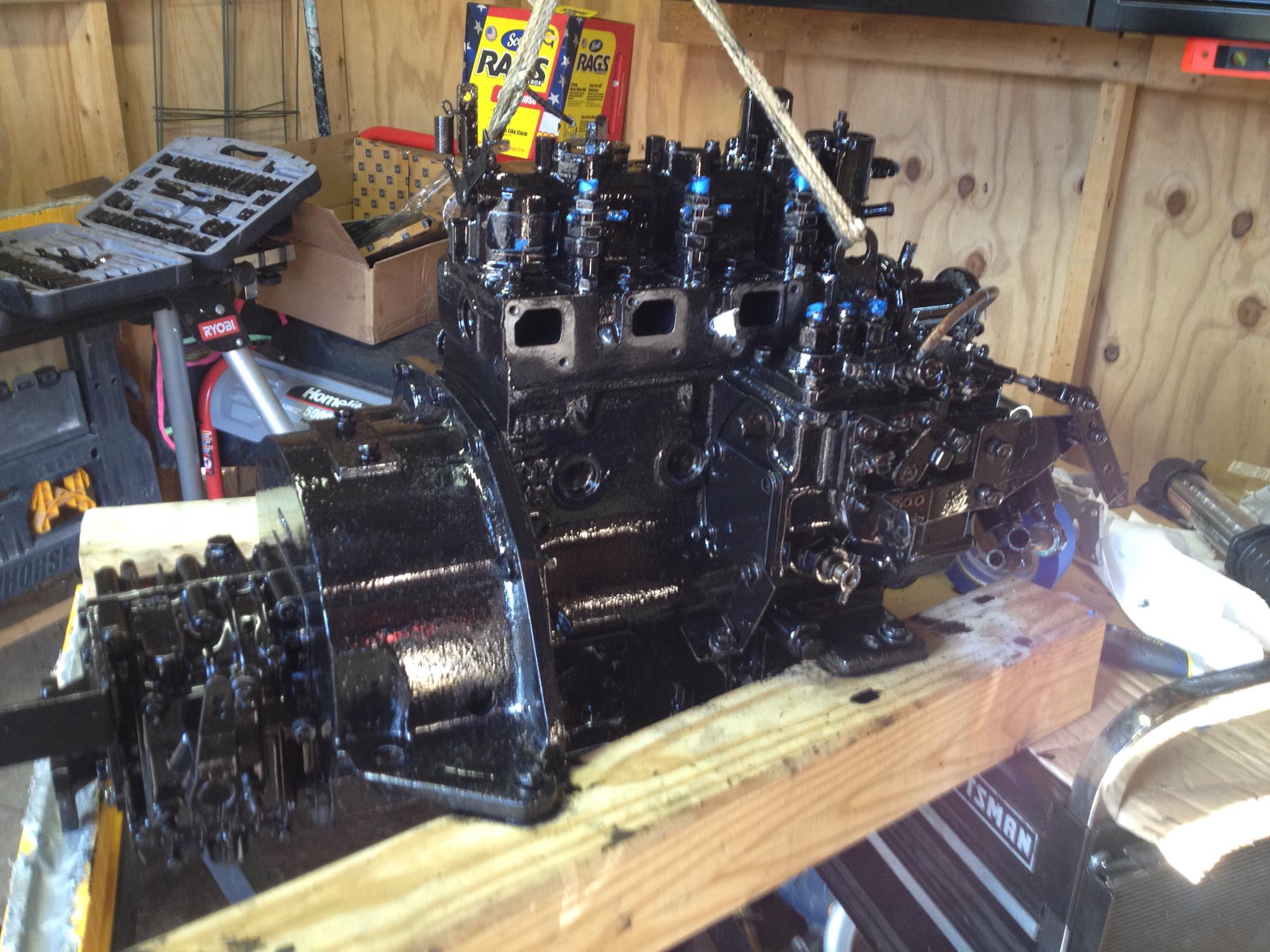

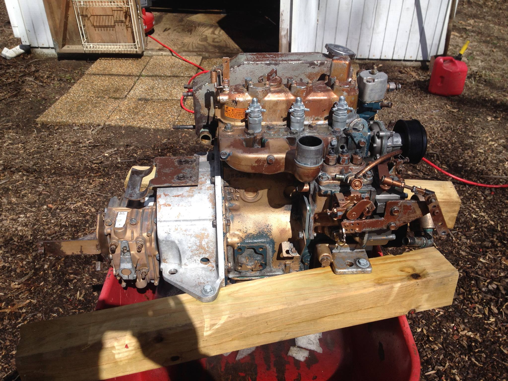

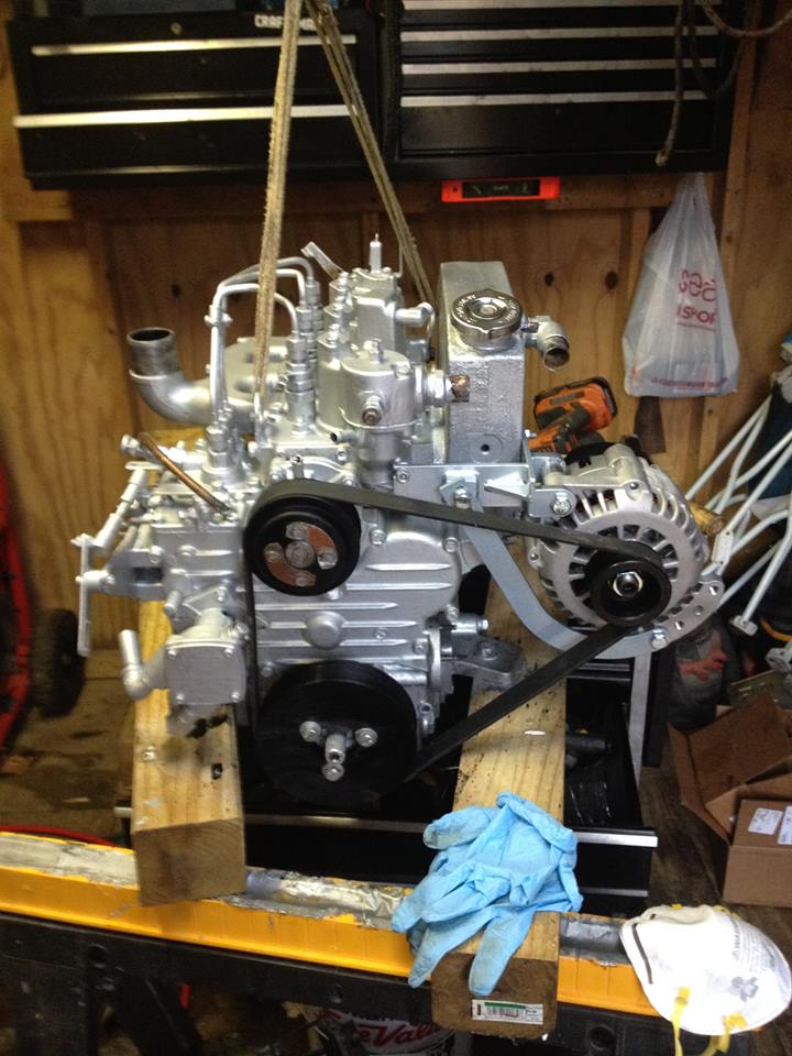

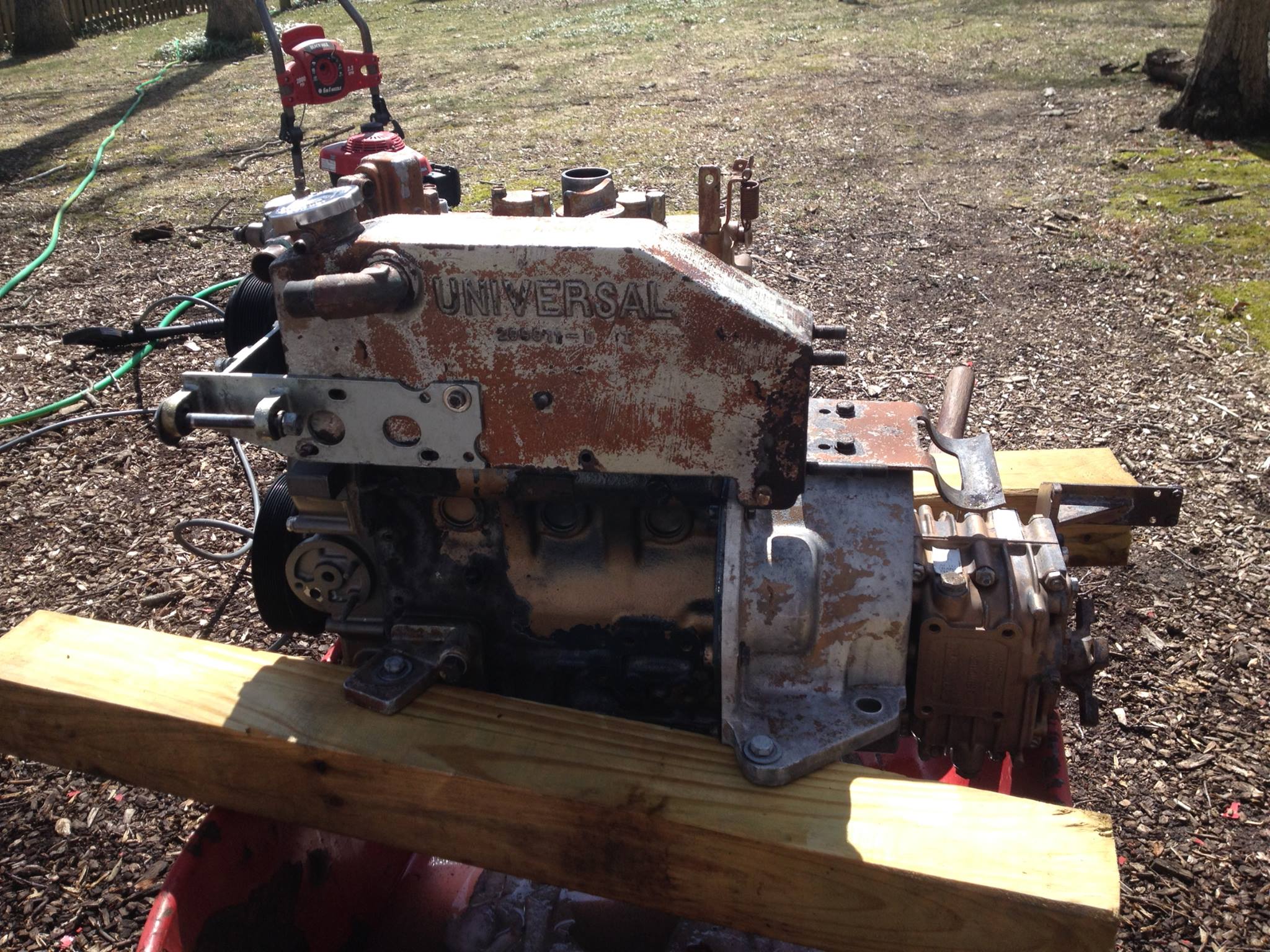

I did this exact same rebuild on the same engine (assume Universal M25) last year.  I bought my rebuild kit from Kumar (​http://www.kumarbrosusa.com/kubota/overhaul-kit-d850-std-with-liners.html) and everything fit perfect.  At ~$650, its a pretty economical way of extending the life of your engine.  For the sake of transparency, I am a licenesed engineering marine officer that went to school and worked on ships but I will say it is a pretty simple rebuild.  It took me two weekends which also included painting the engine.  For painting, I highly reommend the Por system kit (http://www.por15.com/ENGINE-PAINTING-KIT_p_49.html), the results were incredible.
I would suggest taking pictures as you go as some of the maintenance manual diagram are not as clear as they could be.  See attached pictures for before and after.

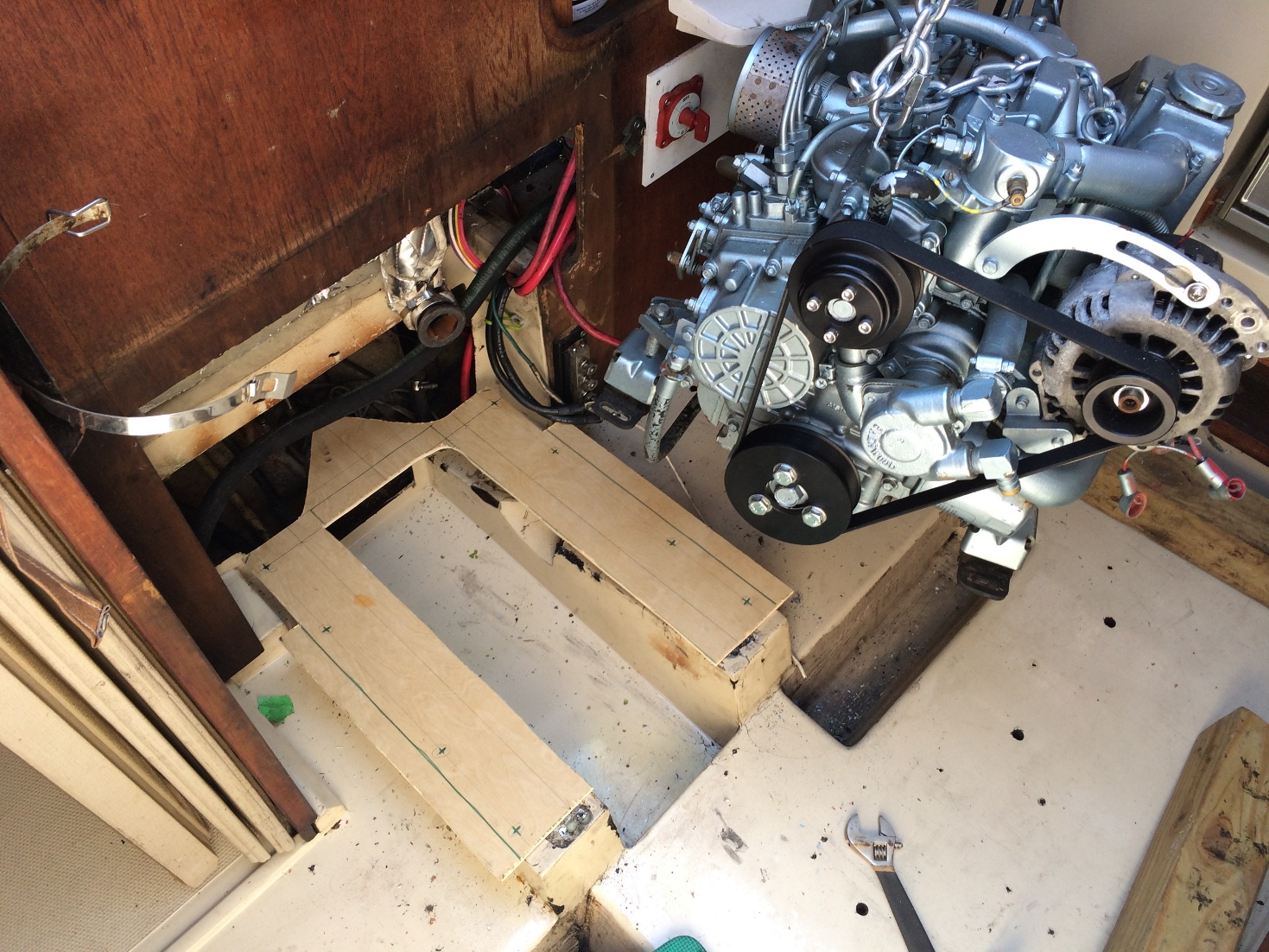

To help provide an answer to the alignment question, I created a template from 1/4" plywood to locate and install the motor mounts for the new M25XPB that I am currently installing.  I used AutoCAD to create a drawing including all of Universal's dimensions and then transferred them to the plywood.  I mad sure to base everything about a centerline including a point that was cutout at the shaft coupling.  This provided confidence that the engine would have atleast a chance of being perfectly aligned transversely.  Note I only had to do this because the M25XPB has different motor mount locations as compared to my M25.  I have attached a picture for reference.
I also confirm I used the exact same technigue as shown in the other picture for removing and installing the engine.  I have done it twice and both times solo.  It takes some planning but is a relatively simple process.
