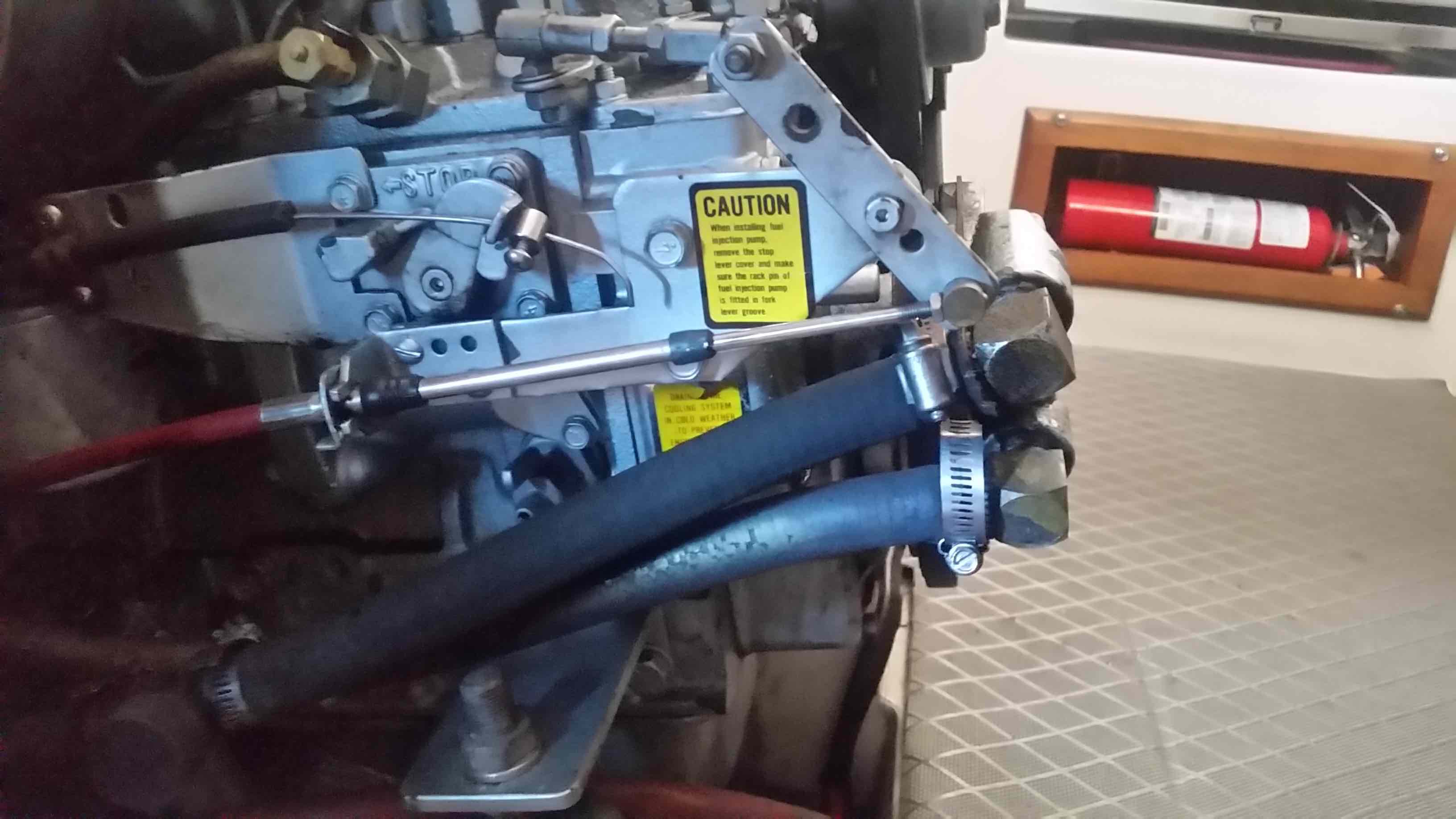

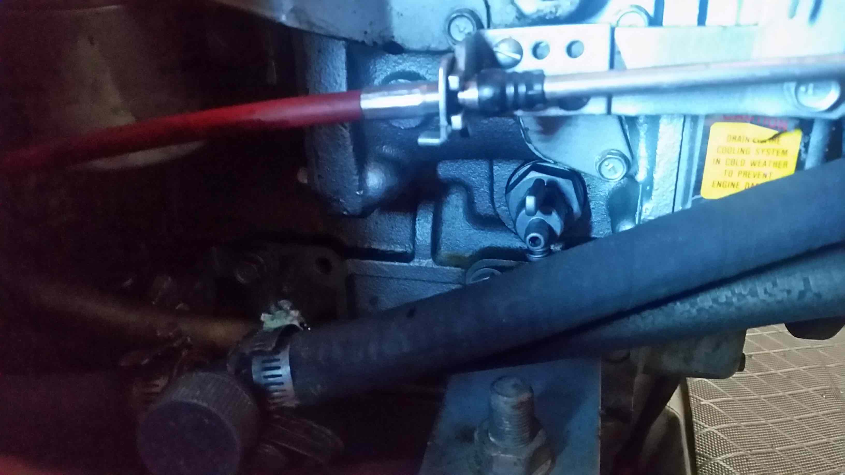

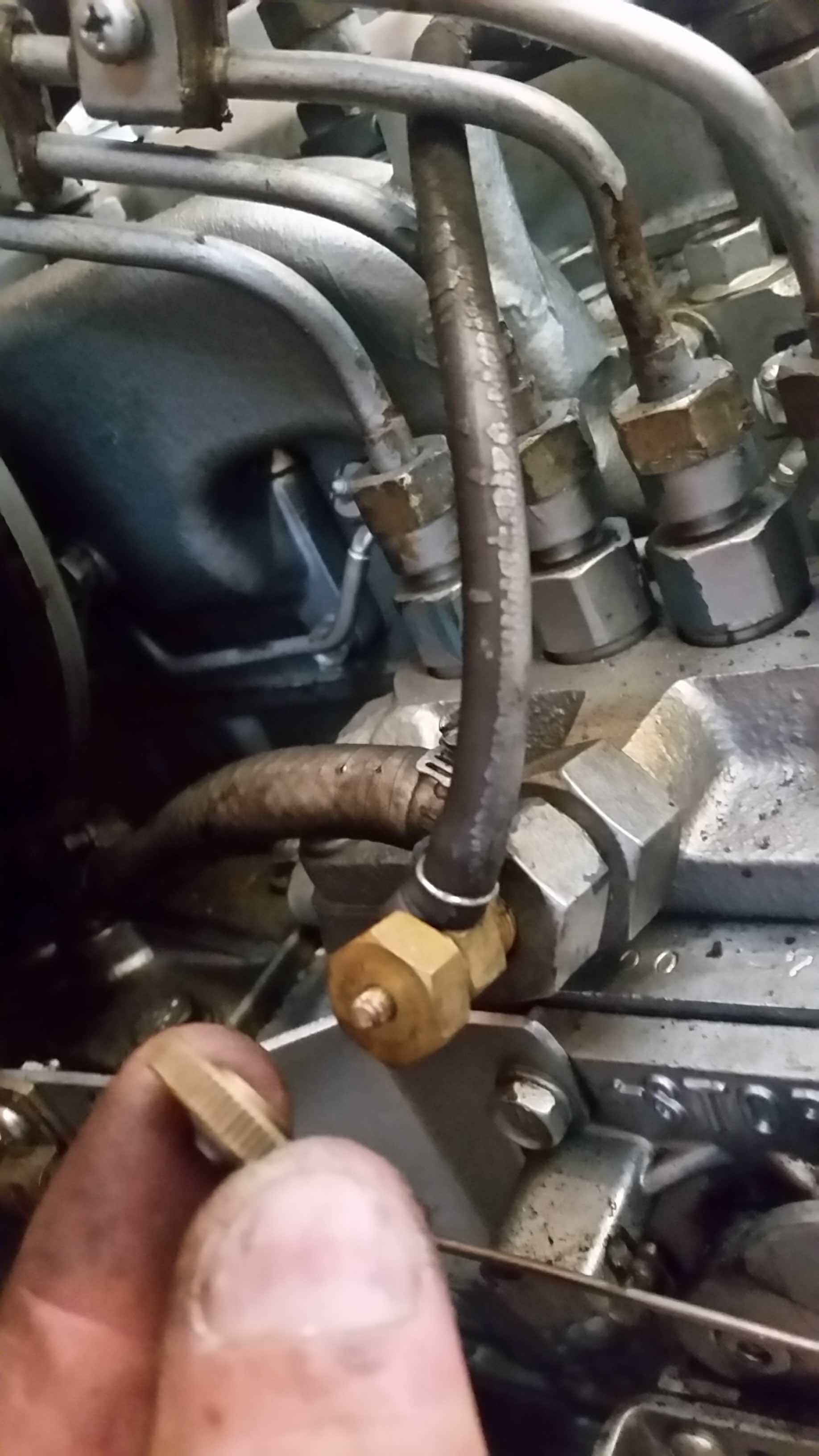

Thanks Dan.  I checked for leaks and found none, but something else occurred to me while changing out the filters yesterday.  On my engine I have a brass fuel bleed valve fitting that has a tube going up the the main injector housing (see photo below).  While the shut off knob has broken off and I need to replace the valve stem and knob, this appears to be a self-bleeding feature when open.  It was permanently open during the last seasons, however, and I wonder whether this may have allowed air into the system?  After running the engine for some time yesterday following the replacement of the fuel filter I shut this valve and the engine seems to run fine with it closed.  I'll buy a new external fuel pick up pump and will leave the self-bleeding valve closed and see if I still have this intermittent problem.  If it happens again I'll replace the fuel pump and see if that fixes things.
danno
Joined: 3/15/17
Posts: 43
Hi Kevin:
I'm not familiar with a self bleeding valve on any diesel engine the size that we're dealing with.  Does the M-35 manual tell you to keep that valve open?  Until you get into much larger engines, the valve on the injector pump is usually dedicated to priming the system after maintenance.
If the lift pump isn't performing up to par, that valve could definitely contribute to a performance loss.

I had same issue w my m25 1985  after changing fuel filters.   It was the bleed screw shown I ur photo.  It has to be shut.  Good luck
Posts: 254
Thanks!  I didn't fully absorb this comment of yours until rereading.  So my problem was that bleed screw/valve being open.  Thanks for pointing this out as I HATE intermittent mysterious issues.  I'm replacing the broken knob and will keep it closed after bleeding post filter changes.  K.

The knurled knob bleed on some M25's should be closed according to the manual but most of us run them a qquarter turn off closed.  Closed the engine should keep running inf the lift pump fails.

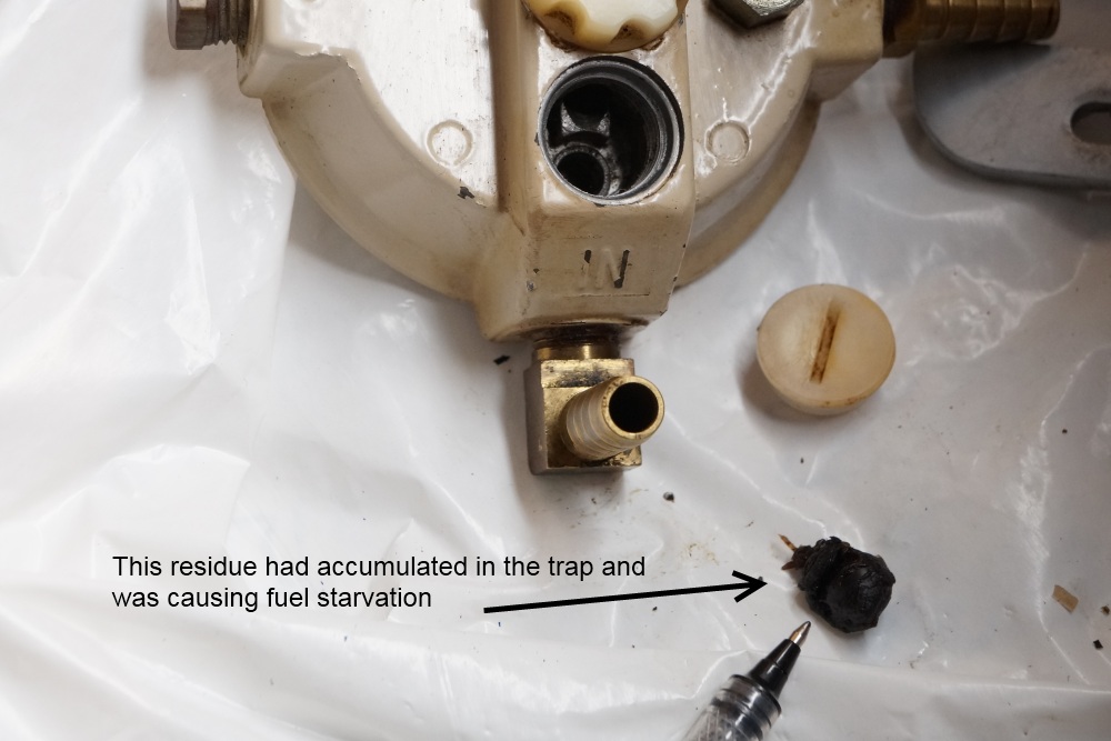

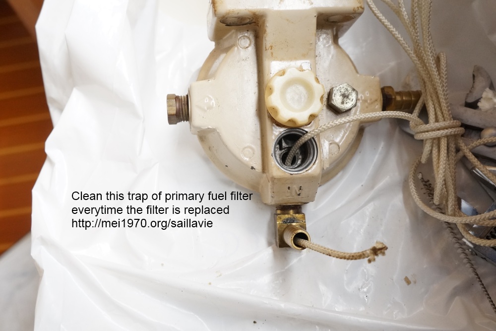

In Sept 2020 on a trip from San Francisco to Santa Cruz in 8 foot seas and 40 knot wind near Ano Nuevo ( 20 miles north of Santa Cruz), the engine RPM gradually decreased and finally stopped. I restarted it and put back in gear but in a few minutes it died again. I found if I did not revv-up the engine it would continue to work.
At the doc I was able to locate the blockage that caused the starvation. As all others have pointed out it is the primary filter.
I removed the mounting bracket out to try and clean it - but it is not necessary. Just remove the cap on the top of the primary fuel filter and clean the accumulated residue. You may turn off the fuel tank valve and disconnect the incoming fuel line and clean the 90 degree angle. I used curtain pull string to clean the path. It all worked fine after this cleaning and replacing of both fuel filters.
