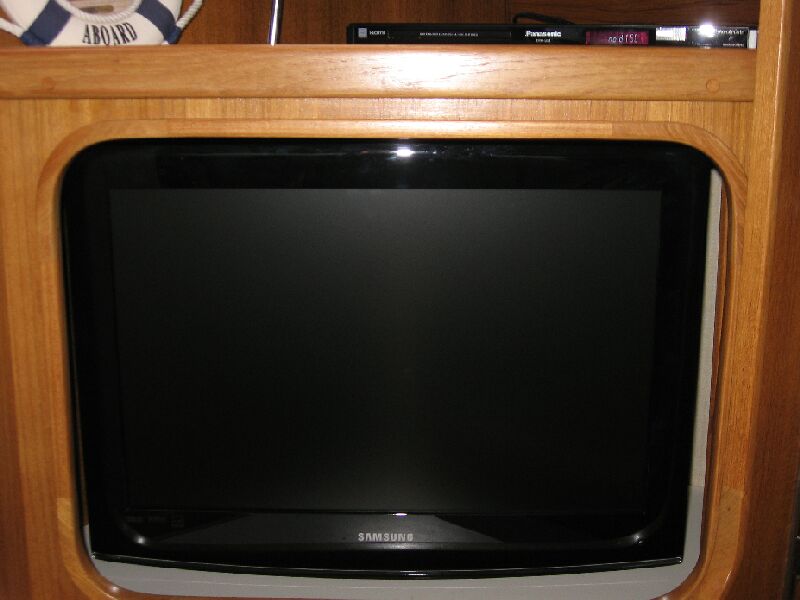

stone21's picture
stone21
Joined: 10/1/08
Posts: 19
Just purchased boat 2 months ago, hull #2128. PO had already installed hinkly hoop antenna. I added 22inch LCD TV with built in Digital Tuner. Works perfectly. I recevive both digital and analog channels. Most stations are duplicates. I expect to lose the analog ones in February. I actually have
more clear stations now then when I had analog with my old boat. Althought the TV is not DC, I got a good price and had many choices. Must invest in an inverter now for when on the hook.
