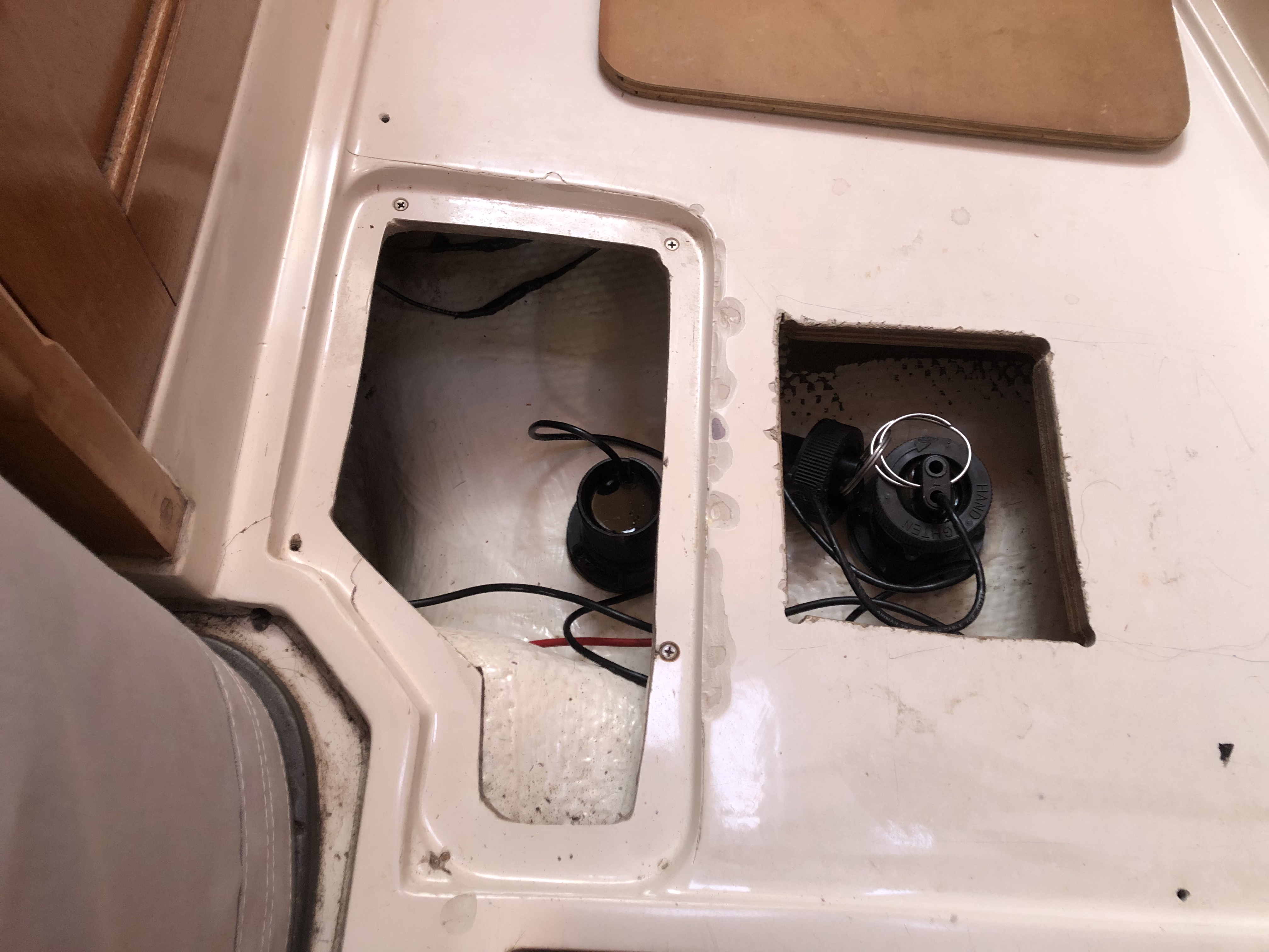

Hi - I have a Raymarine I 50 tri-data connected to an Airmar P319 depth transducer.  Looks like the current transducer was installed in 2015.  The transducer is located under my galley sink.
I get a lot of false readings and shallow water alarms that are annoying. I do not think I had all these shallow water alarms when I first got the boat in 2017 - not totally sure about that.
The Airmar install guide does not recommend installing behind the keel on a sailboat where mine is located.  Based on my research the best location for a depth transducer is in front of the keel on the center line.
Do other C36s have depth transducers located under the galley sink?  Is this a decent location for the depth transducer?
Do I need to move my depth transducer?
Any other suggestions to get my depth transducer working better?

Yes, definitely in front of the keel. It must be in undisturbed water. If there are strong currents below it reads that depth as if the sound was bouncing of the land, even when installed in front of the keel.
Ours (from what I can tell, the original) is under the galley sink as well.  Never had issues...

Depth sounder installed in front of keel near the paddle wheel speedlog.

Our's is positioned the same as Durk's. Do you have paint or growth build up? Both can impact performance.

My transducer on the 1985 C-36 ft was aft of the transmission.  It gave out mid-season.  I replaced with an Airmar transducer similar to this one:   P95M Chirp-ready In‑hull | AIRMAR
I was able to do it while the boat was in the water.  I mounted it off the center line about where the mast is, but under the starboard cabin adjacent to the mast in the saloon.  While not the perfect location, it works fine.  No worries about hull leakage and readily accessible by removing one drawer.  A good compromise.  If you have the long keel, the offset is 4' 4".
