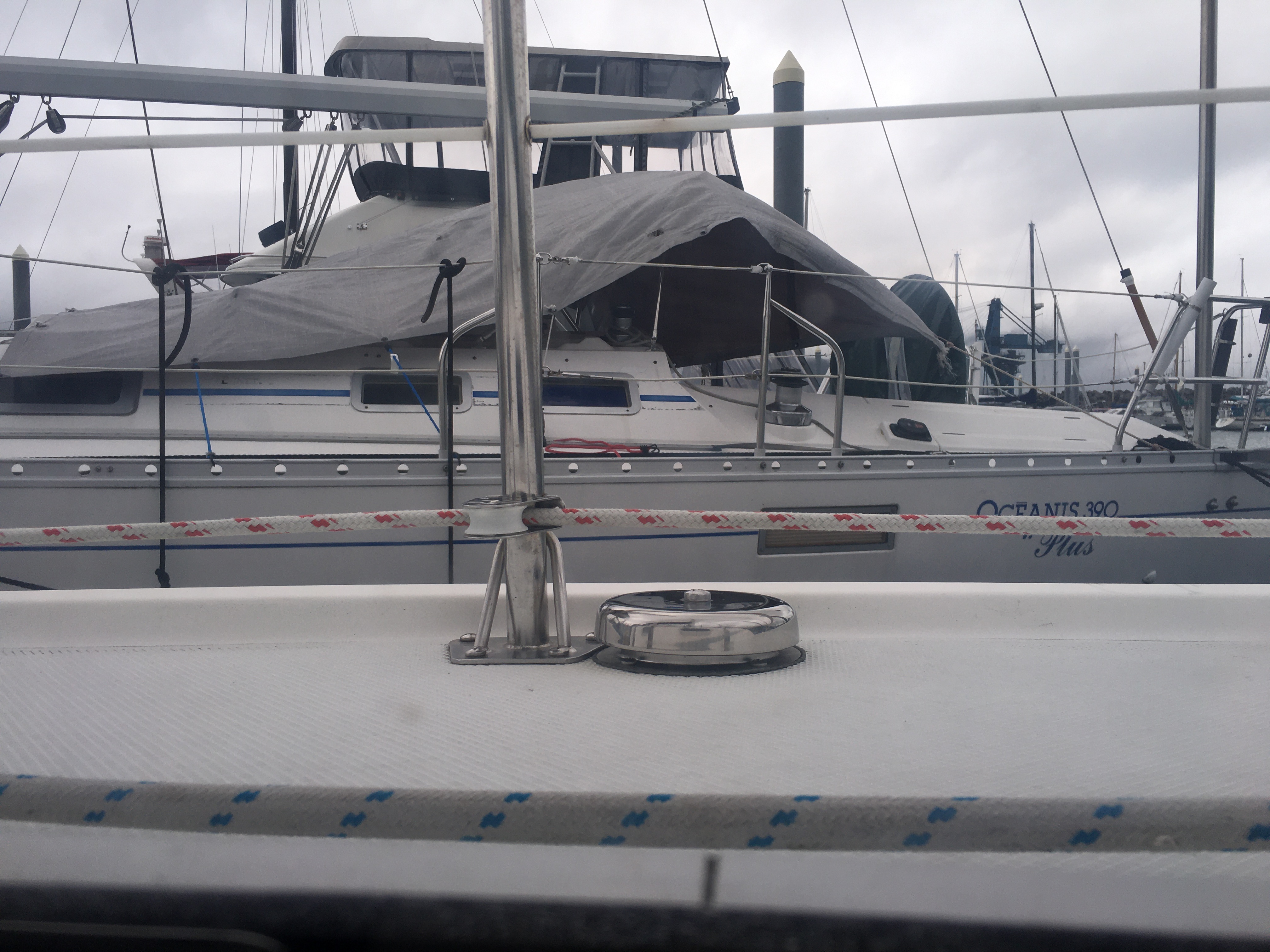

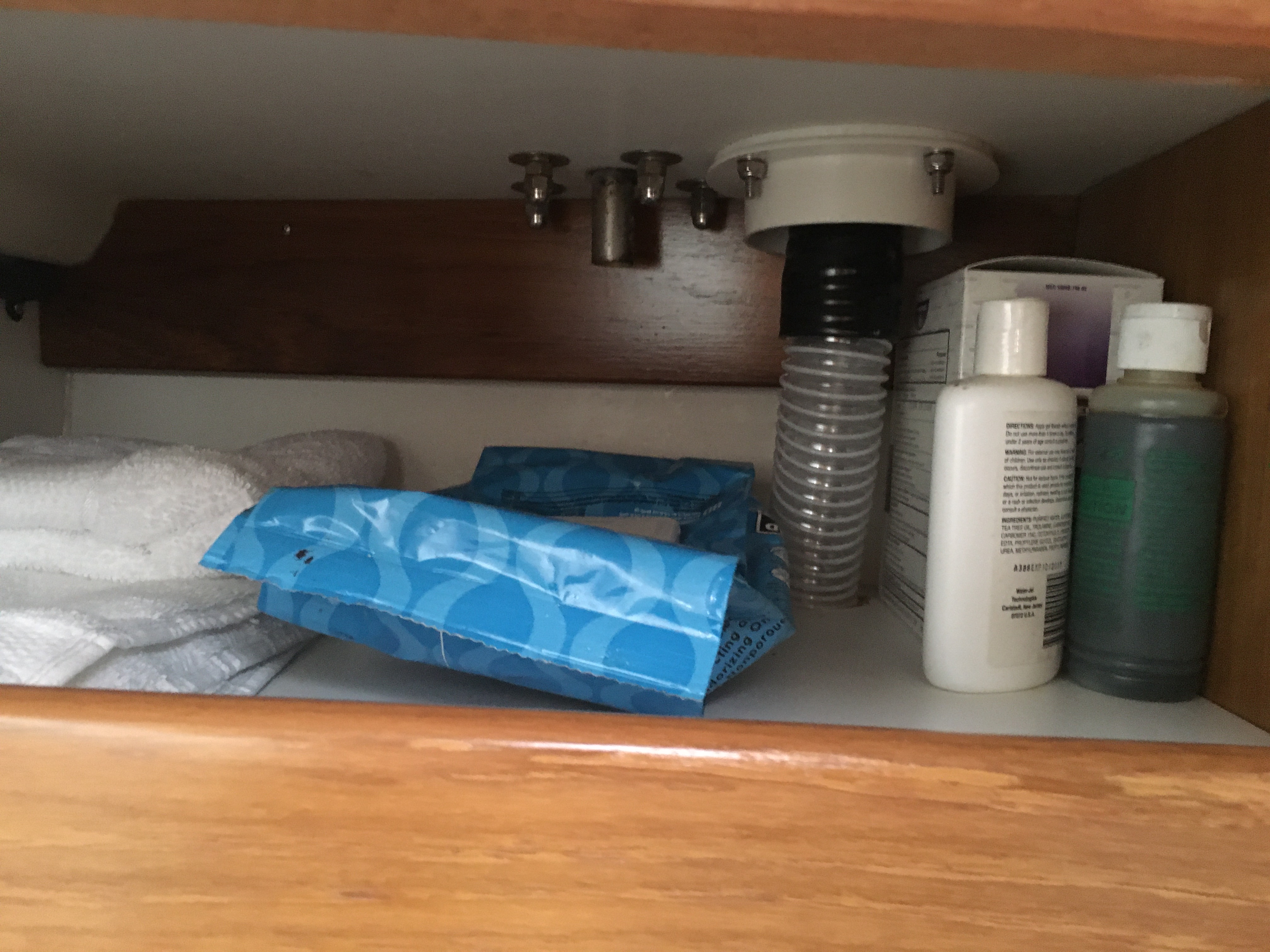

I installed a Natures Head composting toilet in Xena last year, and didn't worry about the fan until this spring during haul out. I really don't think the vent was all that necessary, as there was no odor or other issues. Once the Admiral realized that it was suppose to be vented she insisted I install the vent. The vent hose came with the toilet and I bought the Mushroom vent from Natures Head, ($75) which is a Ventus mushroom vent,  and installed it next to the old vent stanchion. This allowed me to enlarge the existing holes in the cabinet for the old tank vent hose, so the new vent hose is not exposed. When we sail the vent is screwed closed, and has a rubber seal to prevent water entry. We love the composting toilet and the Admiral is now convinced that the installation is correct and complete. I will add pics when I get back from the boat this next weekend, must have deleted them by mistake.
