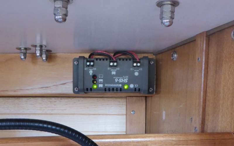

Here's where I mounted my solor controller.  The shelf above the nav station in the aft corner.  The wires are routed behind controller and then behind the long trim board.  The PV wires go through the bulkhead, to the aft cabin, and then up through the opening hatch.  The battery cables go down from the controller into the back of the electrical panel to a "hot" fuse block.
(The solar controller is mounted upside down in order to help keep the wires from being disturbed by objects on the shelf).
