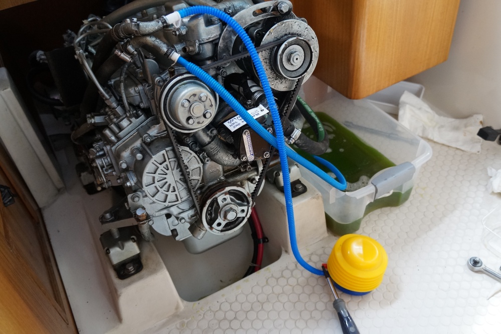

Yes - remove the plug on the port side of the engine block and remove the filler cap. I cut a plastic bottle in half and directed the coolant into a plastic tub.
To rinse the engine and HX -  I poured one gallon of distilled water into the filler cap and let it drain from the plug below.
To flush the entire content of the the hot water heater coil I disconnected both hoses near the thermostat and I used a dinghy foot pump and forced air into the hot water heater hose and drained from the other hose.

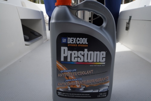

You need 2 gallons of antifreeze, it must be suitable for diesel engine. Here is what I used.
2 Gal Antifreeze  Preston DEX-COOL Extended Life - with Ethalyne Glycol (EG) - suitable for diesel engines  Walmart # 001024731 $14.27

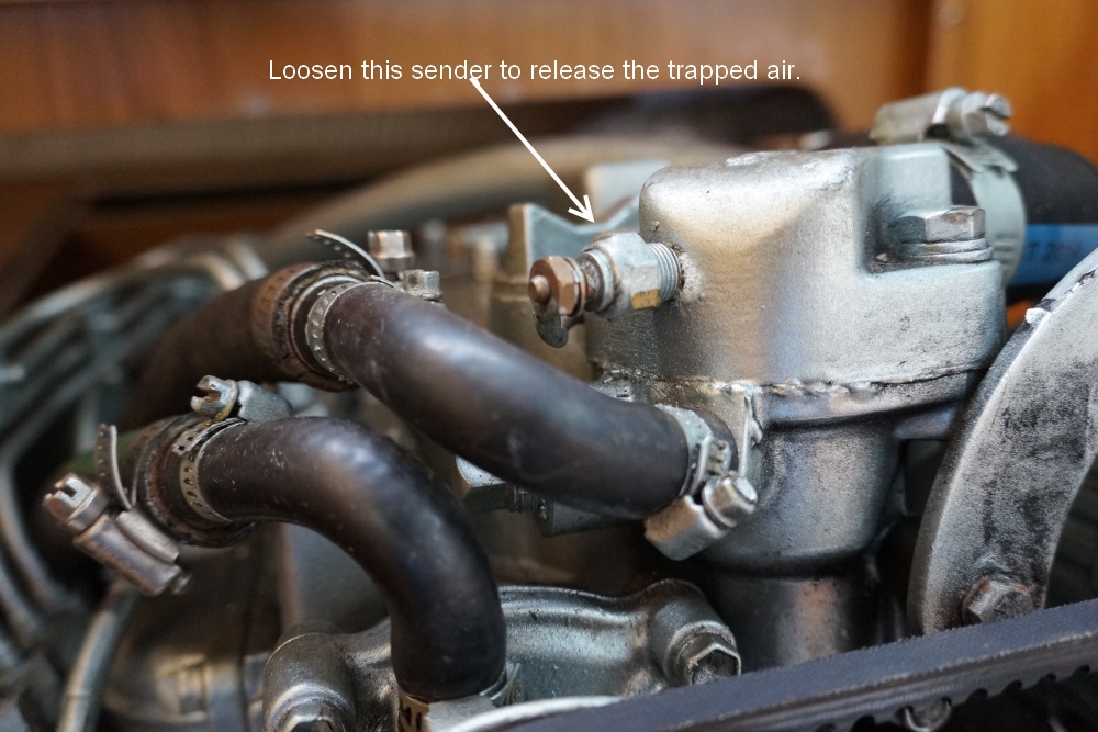

At this point there is plenty of air trapped inside the engine block that must be burped. Fill the reservoir with antifreeze and turn on the engine and watch the water temperature. Turn off the engine quickly as the temperature goes above 160F. Loosen the water temp sending unit until you see bubbles coming out followed by liquid antifeeze. Be sure that you have plenty of antifreeze in the reservoir above. Tighten the sending unit until there is no more leaking of liquid.

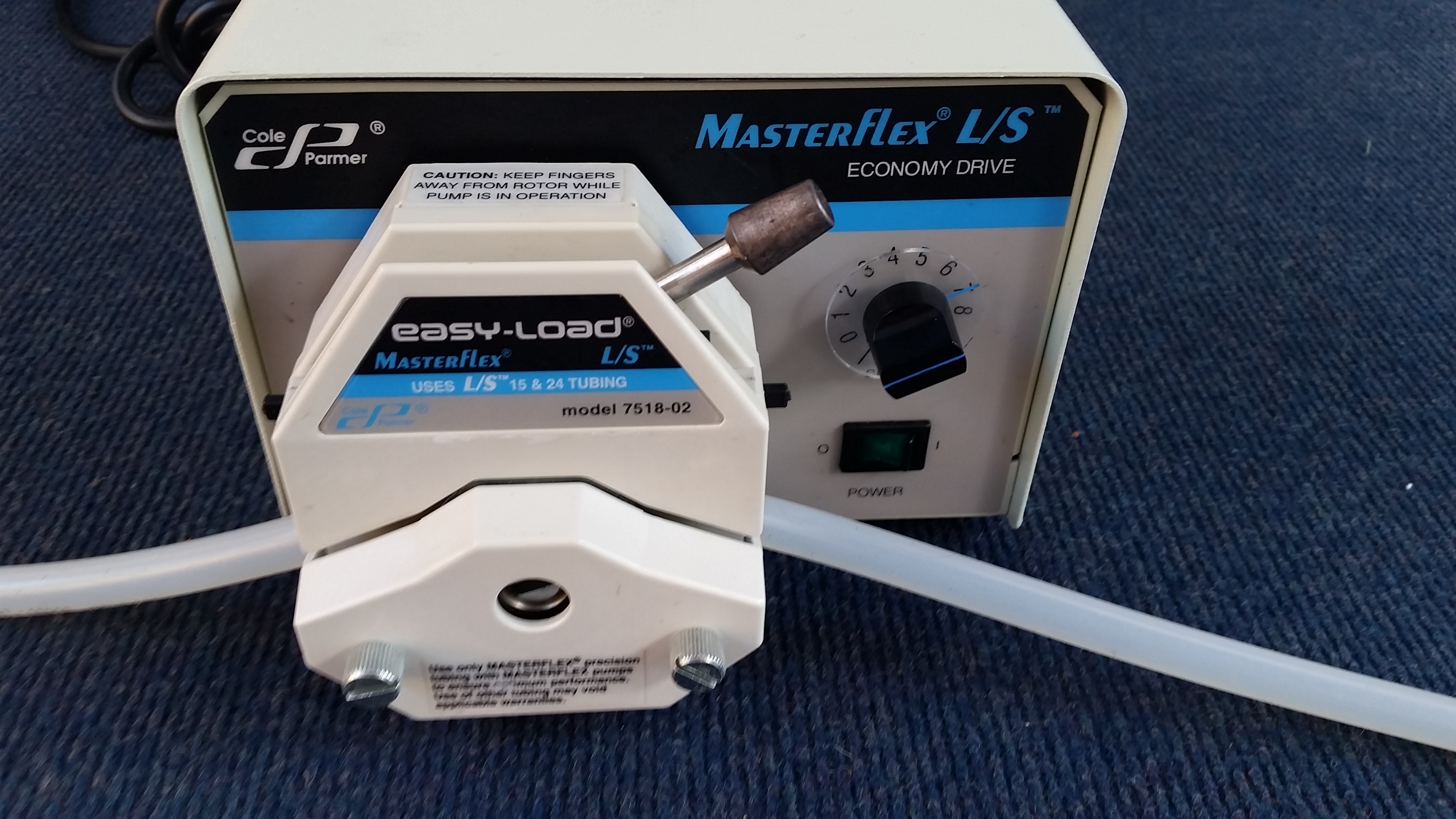

My only change will be that I will use a peristaltic pump with silicone tubing to move distilled water or new coolant in the hot water heater hose loop.  I work in a lab so I have free access to a peristaltic pump.  It is a great tool for moving liquids in many applications.  See photo:
