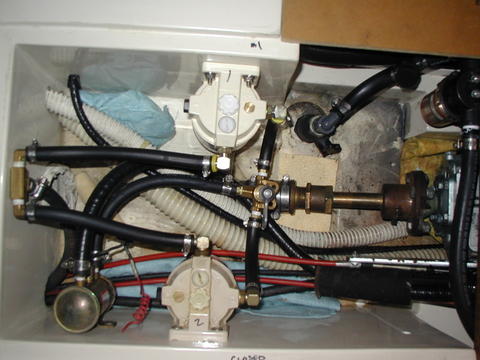

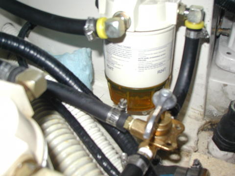

I found the pictures from the 28 website of the fellow's boat who installed the dual filter system. There is a lot less room in the 28 for this than there is in the 36, might be able to do it on one side of that area instead of on both sides.
In the photo, the fuel pump and filter at the bottom are in the stock location. The filter opposite those is the one he added. The fuel tank on the 28 is in the aft starboard side. So the stock flow was from tank to the fuel pump, but he changed it so the flow goes to the T block at the back and from there to both filters. Then it exits the filters and goes to a switch which lets him select either filter. Then to the fuel pump and onward to the filter at the engine.
Not a terribly complicated system and it works. Probably the hardest thing to do is find the plumbing pieces. Just noticed I think the filter is an R24T which is a 10 mic, first time I've seen anything but an R24S on there.
