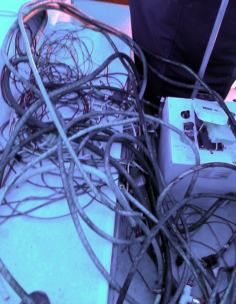

On the weekend I started pulling out some wiring I did not like or went nowhere. A few hours latter the water system came out as well... I really need to start putting this boat back together. Does anybody know where all these hoses and wires went? :D
This friday I am pressure washing what is left inside the boat and then I will begin to reaasemble. Windows are rebuild and the frame power coated. Relacement port bulkhead ready to go. Electrical system.... and the water sytem still need a bit of thought. Has anyone replaced the Hot and Cold water piping with PEX or simmillar product?

If it were my boat, they would go in the garbage can.
[QUOTE=Wavelength;12536] Has anyone replaced the Hot and Cold water piping with PEX or simmillar product?[/QUOTE]
From what I've read in some of his posts, I think Mainsail has used PEX on his boat. I know if I was doing anything major, I sure would. Apparently it doesn't like UV light, but I doubt it would get much in the innards of a boat.
That old hose and wire looks shiny and new, shoulda left it in....:rolleyes:
Ross,
Your boat will go much faster, and you will be much prouder of her, without all that old wiring and plumbing. Good for you!!!

[QUOTE=Wavelength;12536]Has anyone replaced the Hot and Cold water piping with PEX or simmillar product?[/QUOTE]
Here's the prior discussion regarding PEX, for what it's worth. I would use regular hose.
[url]http://www.catalina36.org/forums/showthread.php?t=1100[/url]

I have been doing some reseach on this. Most of the high end builders use it in boats. UV should not be a problem as all the piping is enclosed under the sole or seating areas; nor should oil (Oil leaks get fixed). The biggest cost is the crimper if you do not use the push on fittings. My brother inlaw thinks he has a crimper.
I spoke with the local industrial supplier about any concerns and he said it was the perfect solution for marine work. So this weekend I am measuring up for hose (20' strraight lengths- red, blue or white) and then counting fittings. Supplier will help get all the right parts if I bring in any connections I have to make.
I will take some photos as I go but should be a straight forward project.
