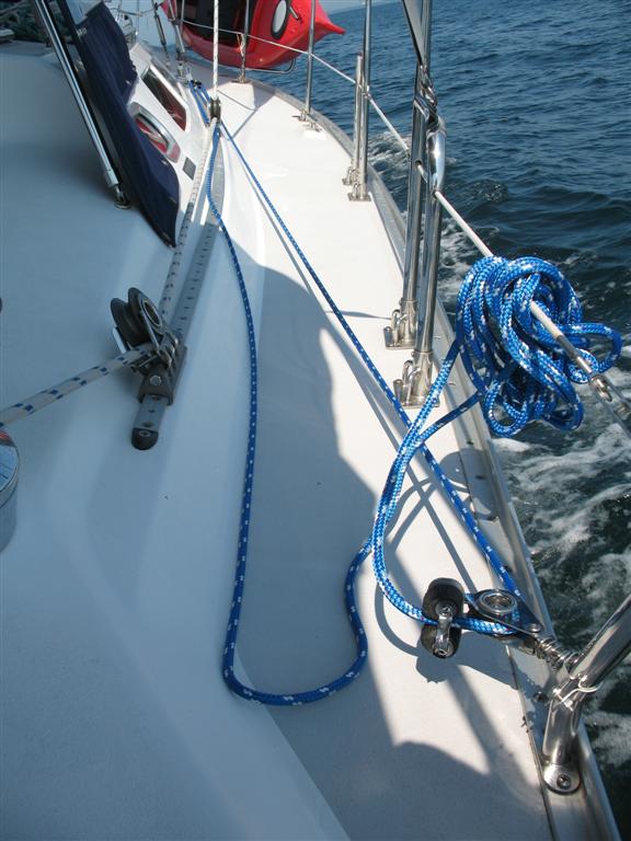

:confused:I have ordered a set of Garhauer ez adjustable genoa cars. Does any one have pictures or diagrams showing the proper placement of the lines between the two pieces on the track?

Both pix are taken from the cockpit. The first pic shows the cars rigged with a "continuous loop" line. Starting at the eye-strap on the forward (fixed) car, the line goes back thru the top sheave on the aft car, forward to the top sheave on the forward car, back and forth, until you have filled all the sheaves. The continuous loop comes back to the cockpit, and the tail end gets tied to the eye-strap on the aft (moving) car. This setup makes it very easy to adjust the cars forward or aft, even under load. I tried bungie cords tied to the aft cars, but it was a miserable failure.
The second picture shows another Garhauer block with cam cleat which you might want to get, attached to the forward post of the pushpit. It may not be in their on-line catalog, but they have them in stock. The block with cam cleat makes it soooooo much easier to adjust the line from the cockpit by pulling inboard, instead of aft. It also is a very convenient spot to fasten the line, without resorting to adding another cleat and/or drilling holes. Hope this helps.

Mike,
You are correct. They are not the same boat. The picture on the left is my C36, and the picture on the right is my C400. If I had known about the block with a cam cleat when I owned the 36, I would have put it on. As I didn't, I used cleats mounted near the aft end of the track on the rail. The rail mounted cleats are not nearly as good as the block with cam cleat mounted on the pushpit. Night and day difference.

My experience with the adjustable cars indicates that the double blocks at both the forward end of the track and on the car are necessary, in order to be able to adjust the car under load. I don't think a single block at the forward end of the track would come close to providing the needed advantage. Shock cord will not pull the car back, a line is needed for that. I don't have the block on the pushpit, but having seen it, I think I just might add it, that looks like it would provide a more comfortable direction of pull when adjusting the car. I also like the continuous loop idea; but I'll have to refresh my memory of an end to end splice...;)
David,
I agree with Gary. You definitely need more than a 1:1 purchase to pull the car forward under load. A single block at the forward end of the track would only work on the lazy sheet, which is essentially the setup you have now without adjustable cars. The deck geometry is different between the 36 and the 400 (duh!). The aft fixed car came with the boat, and is needed. The 36 does not need one, so re-purposing the fixed car to another track would be fine. Sorry, but I don't have any other pix of the genoa cars on either boat. The pushpit block with a cam cleat is a better solution (IMHO) to the swivel block with cam cleat that Garhauer sells as a "complete kit" for the aft end of the genoa track. I've raced on boats with that setup, and it seems that someone is always knocking the adjusting line out of the cam cleat, and messes up the genoa trim. Plus, the Admiral said she didn't want any more toe-stubbers on the side deck, so..... I've also seen some cam cleats mounted low on the outboard side of the cabintop for the adjusting line, but they were race boats without dodgers. I'm really happy with the pushpit mounted blocks. Garhauer came up with a winner for that idea.
Gary,
The continuous loop is a concept, and not actually how the line is rigged/spliced. I simply used bowlines on each end of the adjusting line (one on the forward car, one on the aft car). I suppose if you want to you could make small eye splices for the ends of the adjusting lines, but I didn't bother. There is no need to learn continuous splicing for double-braid line! Hope this helps.
