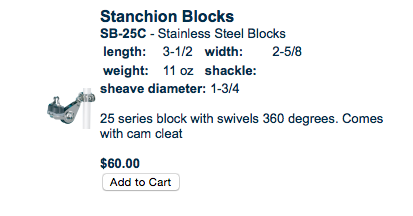

I'm looking at one of the SB-25C Garhauer Stanchion Blocks
for the furler line
Best, Greg
