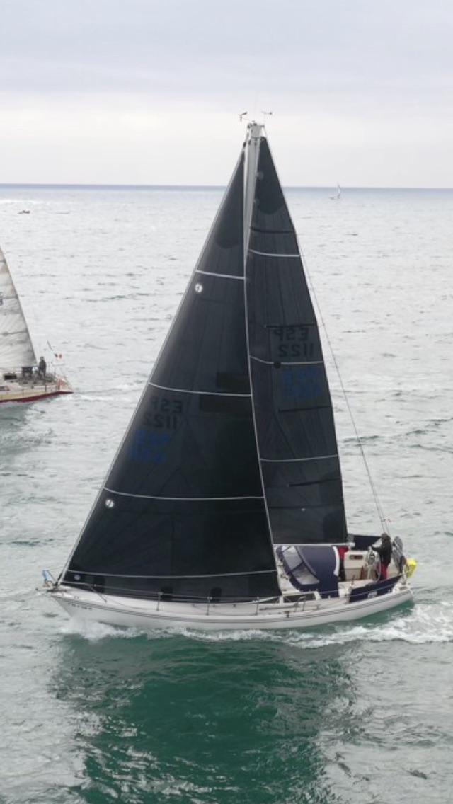

<p> Hi,<br /> <br /> Fully agreed with the previous answer. I have since new a C36 TR from 1991.<br /> <br /> We being &nbsp;Cruising for almost 20 years, including Atlantic passages and cruised&nbsp;almost the whole Mediterranean.<br /> <br /> But since the last 10 years we just race the boat with almost no cruising.&nbsp;</p> <p> So<img alt="" class="image-medium" src="/sites/default/files/styles/medium/public/forum/62E035A1-F381-436C-86D2-A86CB5943CBE.jpeg?itok=NNd6Q207" style="height:220px; width:124px" /> now, our garderobe is full of racing oriented sails. &nbsp;So as said in previous comment, you have to decide what is your sailing program.&nbsp;<br /> <br /> Decide what you want to do a talk to your sailmaker. Just a personal advice, dacron is the more expensive cloth (many will disagreed...) I'm saying this because although is cheap to buy and last long, performance are lost after 2 seasons.&nbsp;</p> <p> Go for a good laminated material, and your sail will keep the shape for years. &nbsp;Just a thought.</p>
