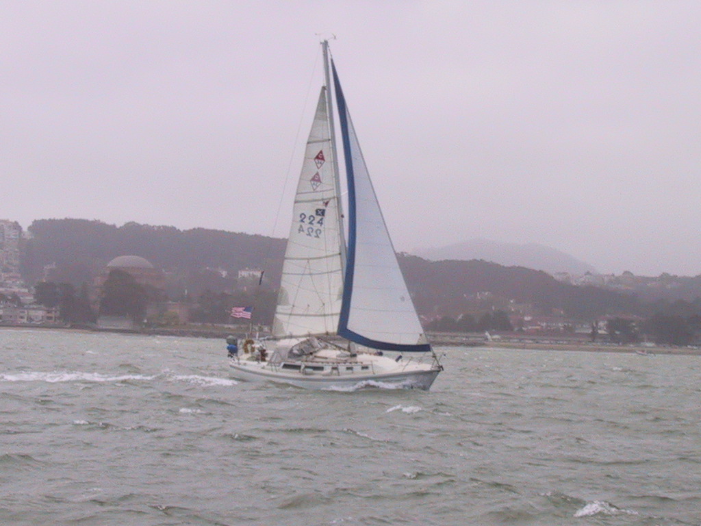

The picture shows our 85 closehauled in heavy wind with the high tack and high clew. This sail is a cut down standard C34 110, much the same as your C36 working jib. The foot was re-cut to raise the clew even higher than the standard 110. The ProFurl furler is deliberately selected to raise the tack off the deck for best visibility. It "just makes it" for sail shape with the fairlead as far forward on the track as it can be. Please note that the top of the sail is quite "slim" and had been cut that way to keep "center of gravity" of the sail low for the higher winds: less of the sail area is higher aloft.
My 110 has the same jib fairlead position for good sail shape based on the clew location. Since the fairlead's as far forward as it's ever gonna get, I can't reef either of my jibs without the top of the jib opening way up. So I don't ever reef the jibs.
