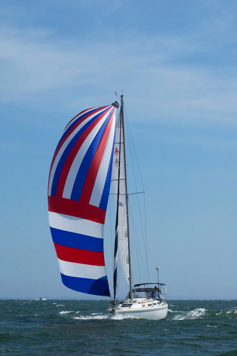

It did work .. and here's the final result:
Wow! How beautiful.
