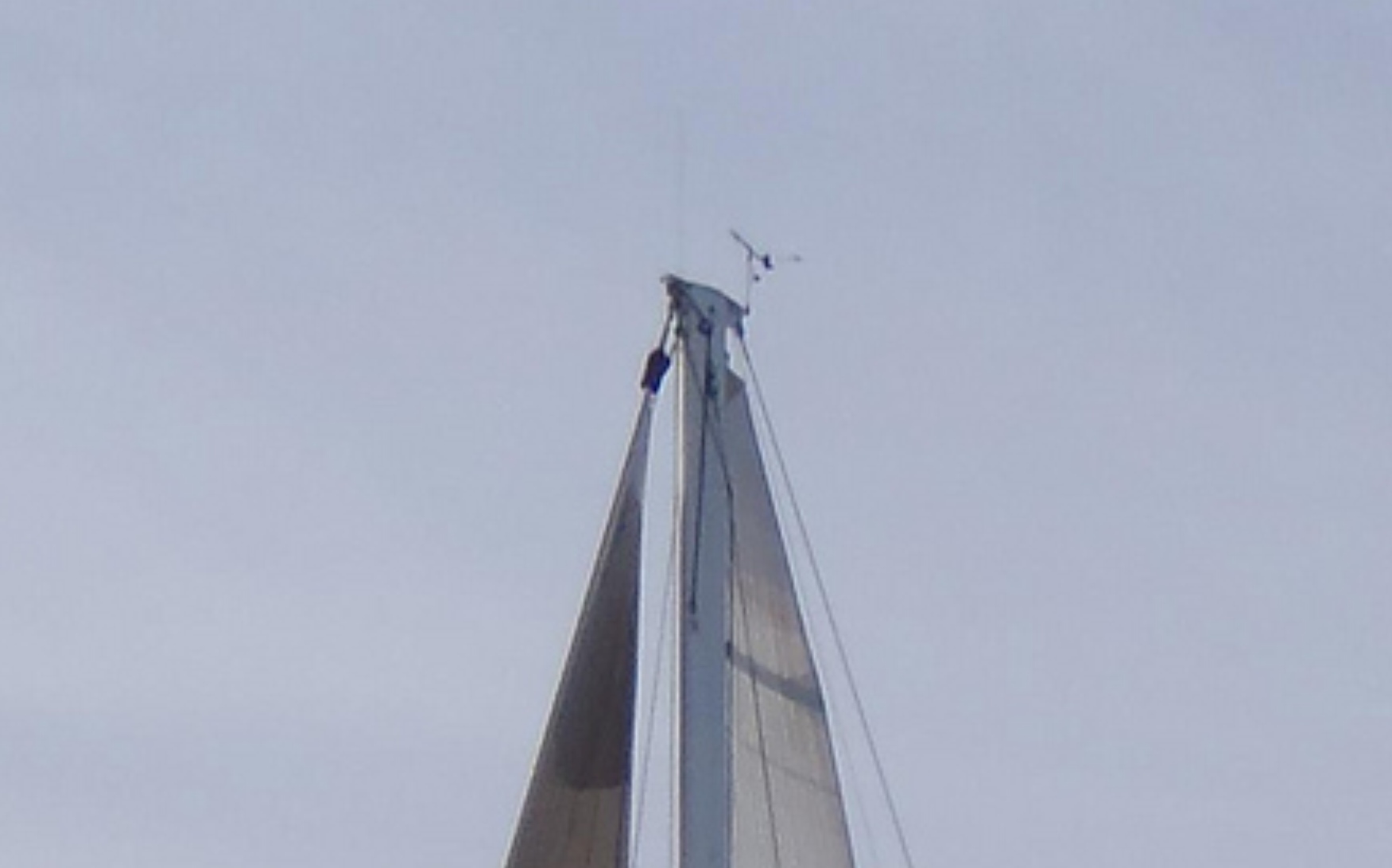

This is the masthead on my older short rig boat but the principle is the same.
The block out in front of the forestay is for the spin halyard. The halyard on my boat goes into the mast about 3' down from the top, but it could be rigged externally too.
The trick is to do all this without having it foul the top swivel of your furler, which mine did when this pic was taken. Among other things the hoop that this spinnaker block is mounted on should be offset as for to one side as you can so that the tail of the spin halyard doesn't drag across the forestay or the swivel.

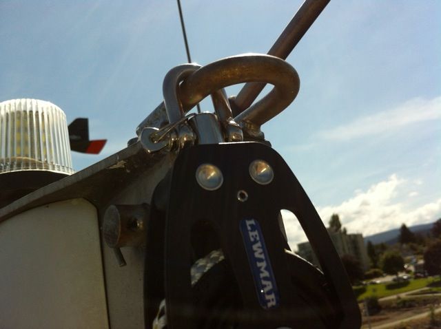

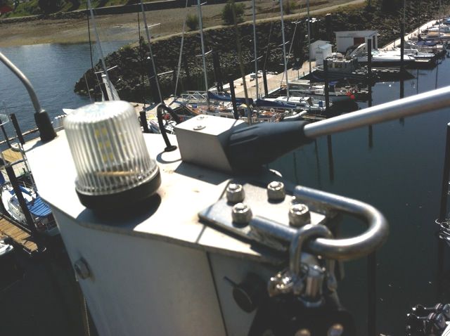

Jason (or anyone else) -
Having just picked up a used assym for our boat from a former C36 owner, we need to add the running rigging to fly it. Your photo was helpful. Do you recall the specs of the block at the masthead you have in your photo (make, model) (or, suggestions as to its capacity)? And, how do you "offset" the block to one side, as you suggest?
Matthew,
A Garhauer Series 40 swivel block works perfectly. Also, I think that the spinnaker halyard exit box in the mast is 2-3' below the masthead on the Stbd side of the mast, and not on the port side. The lower exit box is 6-7' above the deck, also on the stbd side of the mast. If you use those exit boxes for an internal halyard, and you pull the spin halyard back to the shrouds on the stbd side when not in use, I found that I never had a problem with the spin halyard rubbing or tangling with the genoa furler upper swivel. If you "split sides", i.e. have the spin halyard come out of the exit box on the stbd side, and have the spin halyard tied off on the port side, I would sometimes have problems with the spin halyard getting messed up with the genoa furler swivel. Just a thought.

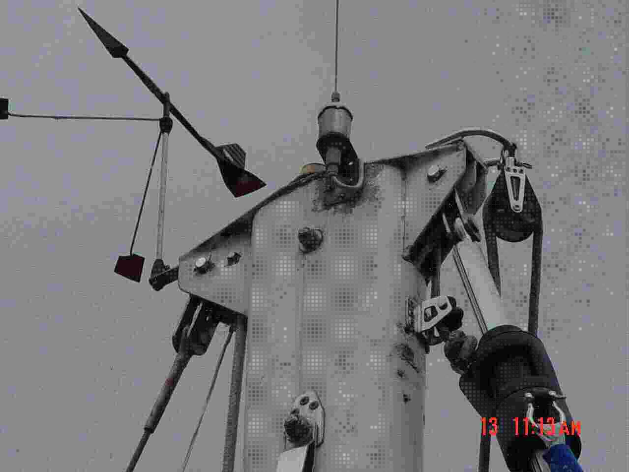

Nimue's picture
Nimue
Joined: 6/23/09
Posts: 429
In this pic you can see the halyard setup. It runs from the mast up to the cheek block on the side of the rig, then forward at an upwards angle to the hanging block, and then the tail runs back down and is led aft outside the shroud to keep it off the furler.
