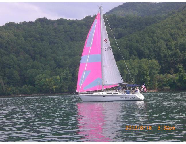

Here's a link to the Selden bowsprit & furler I installed on Whispering Eye 2 years ago. It works great and is handled easily by my the two of us.
http://www.allbookez.com/pdf/161u4dd/
s/v Whispering Eye
2004 Catalina 36 Mk II #2201
SRFM/WK/M35b
St. Petersburg, FL
