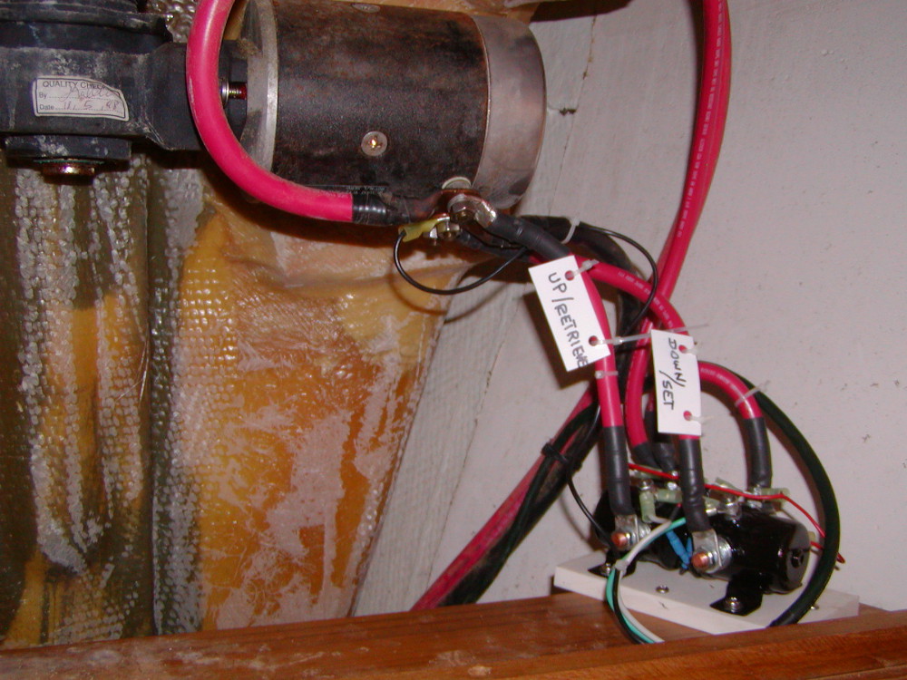

I installed a wired remote control with up/down switch. I found the problem with wireless remote was that after you release the button the windlass motor would continue to rotate for an other second or two. For lowering it was Ok, but not for bringing up. I used two relays with 12VDC coils and 85 AMP contact that was designed to be used on golf carts. I painted them with Rust-o-lium to keep them from rusting. They were weatherproof. They work well. For short-handed anchoring it is a must.

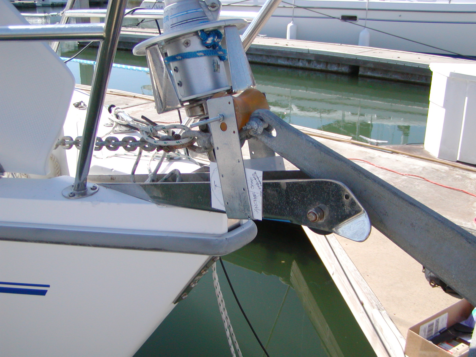

I also added a roller to guide the anchor away from running into the jib roller and be directed into its resting slot. This image is the prototype.
