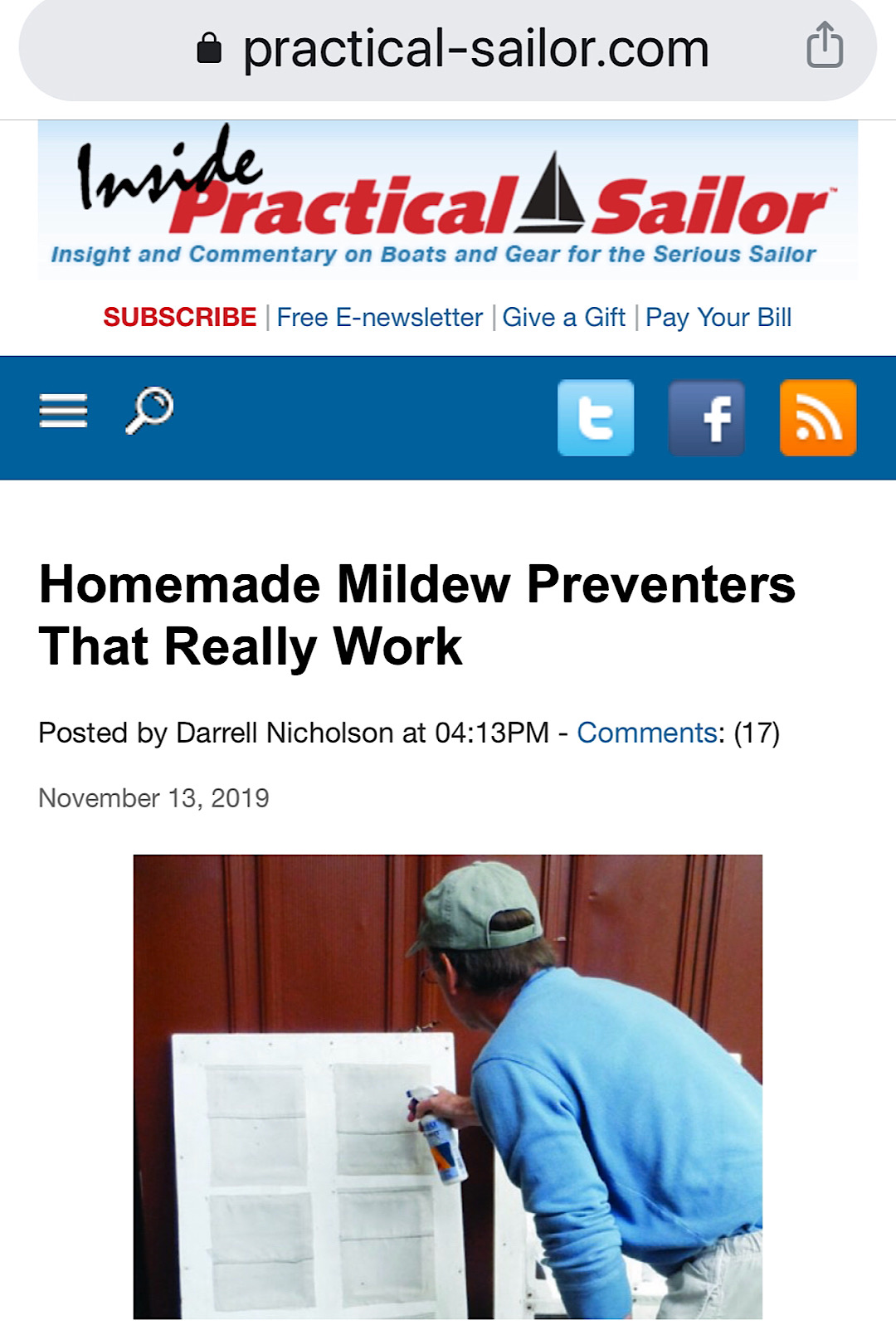

This Practical Sailor article may be of interest to you...
https://www.practical-sailor.com/blog/Homemade-Mildew-Preventers-11249-1.html
