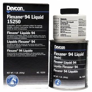

Getting ready to do this myself - so I have been doing a lot of research on this. Here and on other forums.
Which is where I found a different product much cheaper and with similar properties. But more on that later.
The mast should certainly be centered in the partner before the application of the Spartite resin.
If you don't, it will be impossible to center afterwards because of the density of the plastic, which is about 55-60 on the D shore hardness scale for rubber and plastic (think roller blade wheels here.) The Flexane is a 97 on the A shore scale, which correlates to the 55-60 on the D.
To save money, I went with a different product than the Spartite. I bought two units for 75.00 delivered to the house. The tensile strength is different per psi, but I'm not that concerned.
Definitely use Vaseline on all surfaces - including the mast - because if you don't, you will rue the day if you ever try to pull the mast. The spartite will refuse.  Based on my research this is all bad.
Here's what I bought after researching:
http://www.all-spec.com/products/15250.html?gclid=CN6W-aju0cACFcZQ7AodUF...

Match man - the link is bad what was the product called so we can search on it?

Try this link:
http://www.waresdirect.com/products/Commercial-Products/Devcon/Flexane-9...
Pretty good overview of the product.
This is exactly what I purchased albeit I didn't pay this much.
I paid 73.48 delivered for two 1 lb. units.

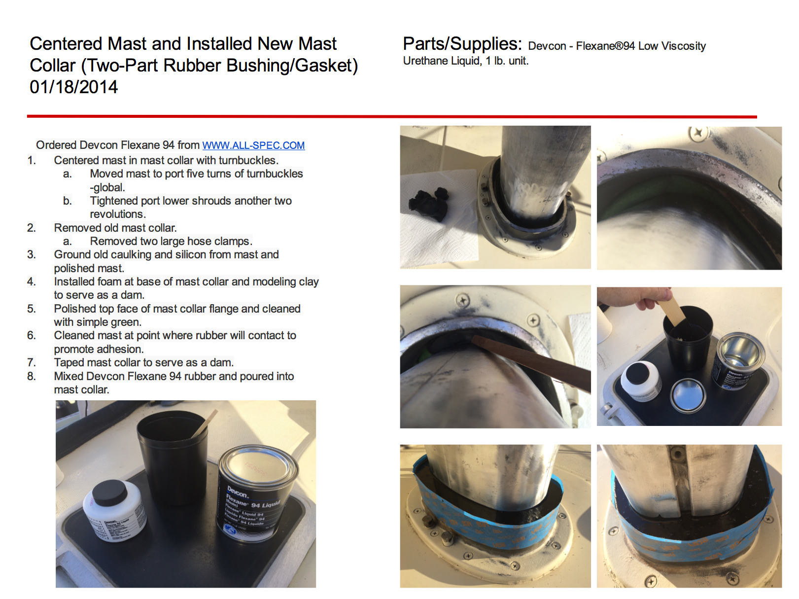

Here's a very brief update from my log on this project if anyone is interested in performing this upgrade on their mast/mast collar.
​My mast boot was leaking like a screen door on a submarine.
In all this cost me about $60.00 and I found that my Milwaukee grinder and a pool noodle proved to be very helpful.
And don't forget the Play-Doh! (Or paper towels.)
