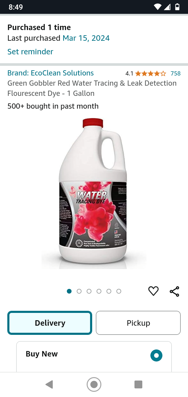

I had a leak over the winter that I could not figure out.  I used the attached product to find it was the water heater had a pinhole.  You will only need a little bit, but I kept the remainder.  You could mix up a gallon or two and dump it in your cockpit.  It does not stain, but is easy to see the red water and it fluoresces as well.
