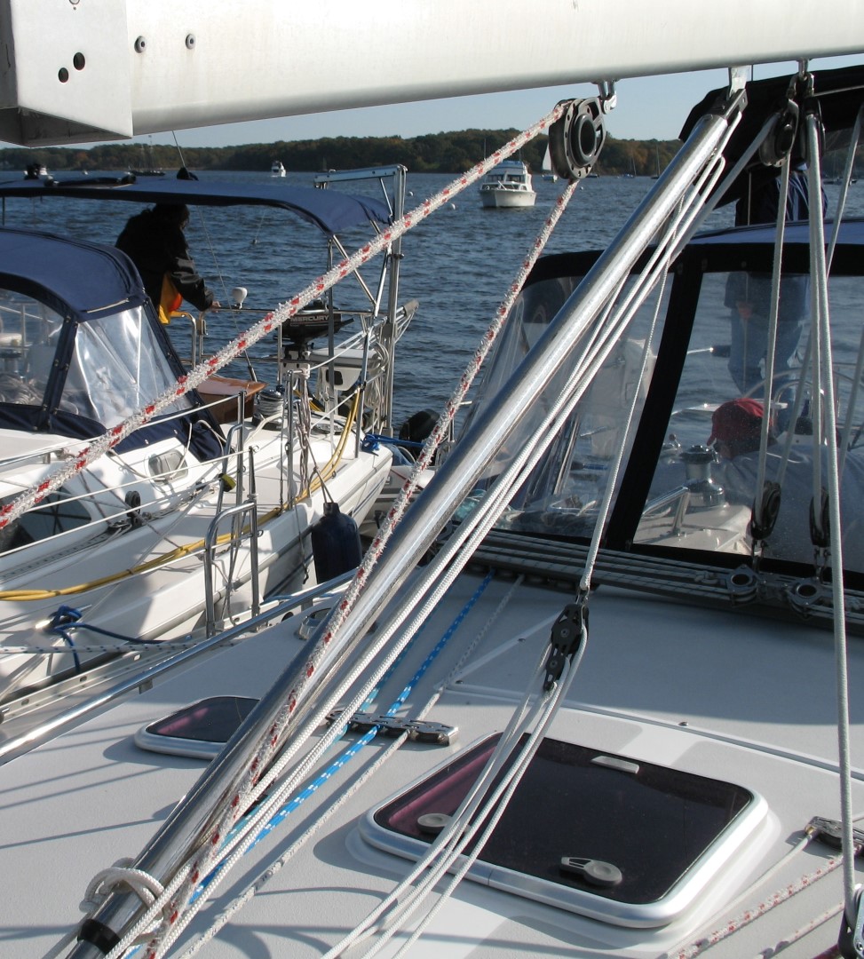

These pix aren't the greatest, but if you look closely, you can see the adjusting lines on one, and not the other. You can't see it, but in the middle of the rigid vang is the "pin" which you mentioned.  I have no idea what it's for.

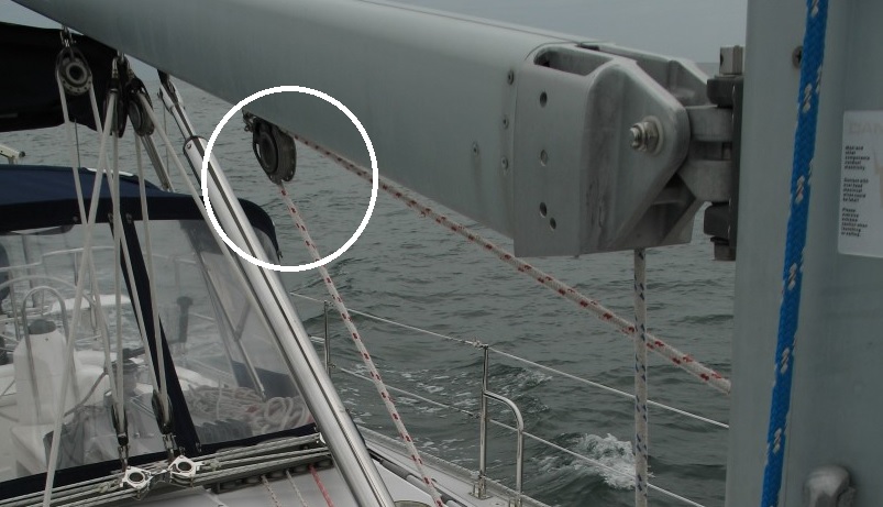

Can you tell me what the block that I have circled does?  It appears to me that adjusting the line that goes through it would change the angle of the boom.

The vang in top picture is the same as mine. Our boat is put away for the season, but in the spring when the cover is off, I do plan on examining the vang closer. It seems odd that they would design a product with 0 adjustment possibilities....but maybe they did, as one of the above posts noted.

I have a roller furling mainsail, and the block you have circled in the picture is for the mainsail inhaul. Above the boom, out of the field of view in that same pic, is the mainsail outhaul.  Hope this helps.
