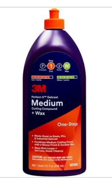

I used this 3M polishing compound with Excellant results on ports and hatches.
