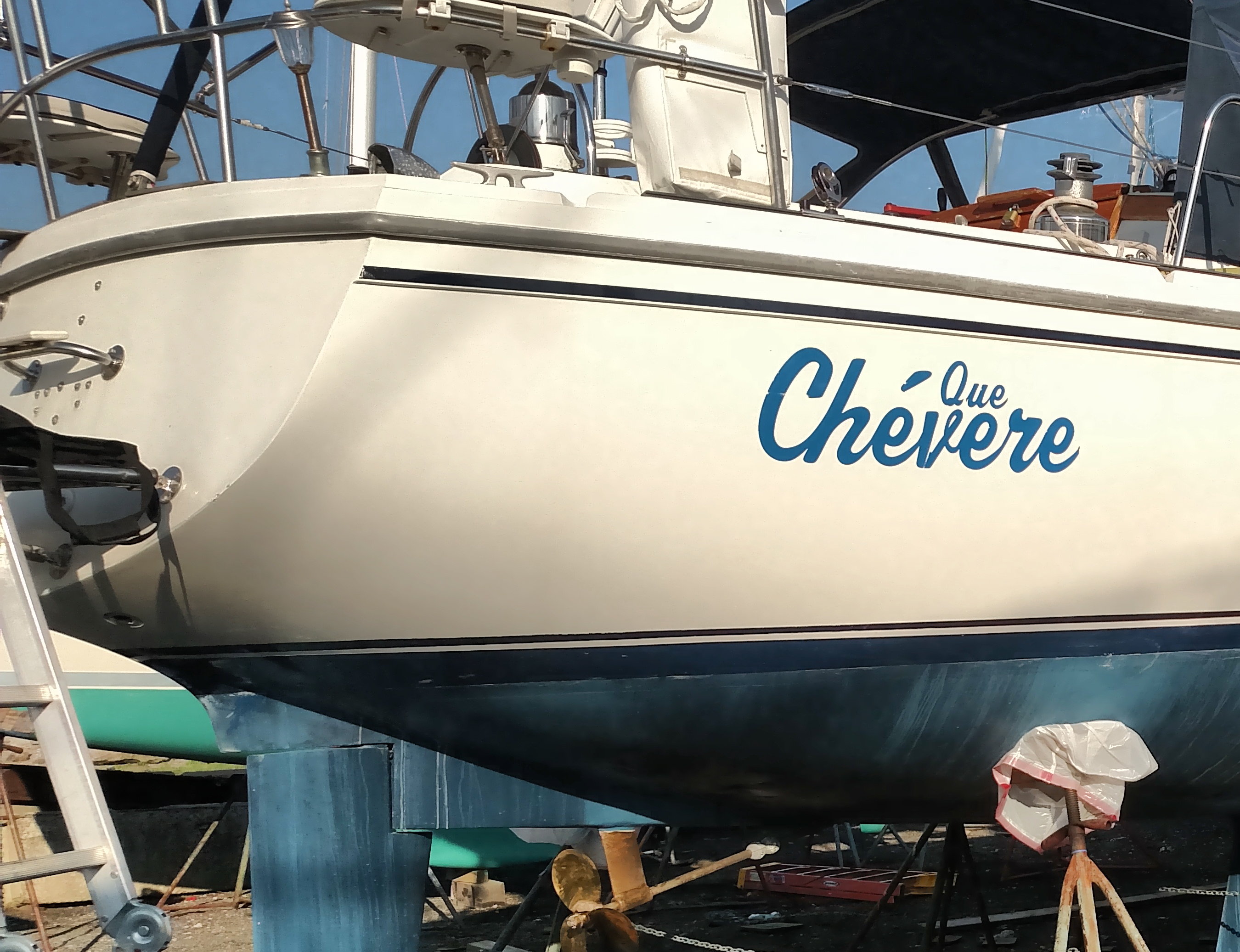

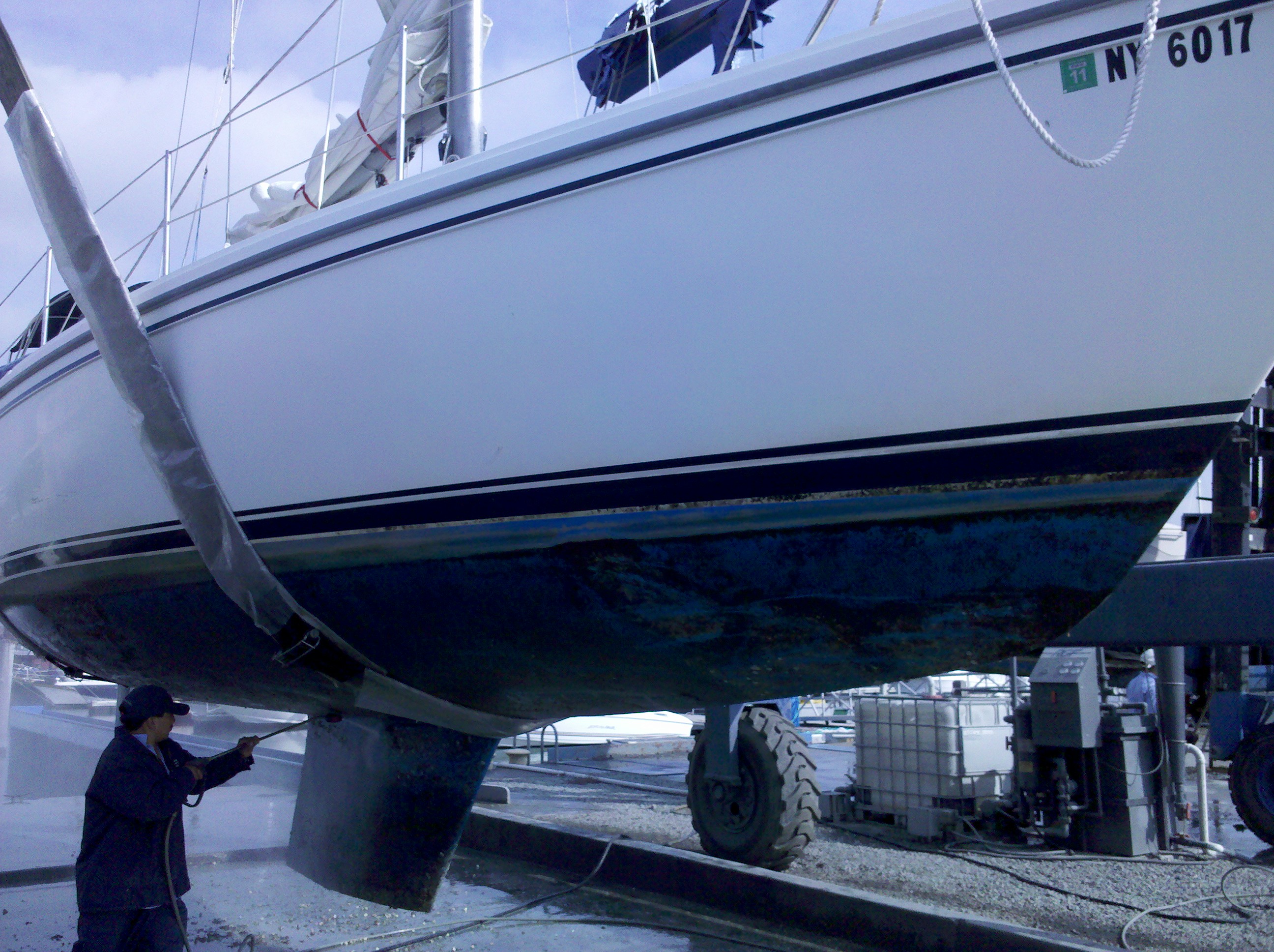

Enrique and Paul may regrettably be correct about the durablilty, but their boats are a decade or two newer than ours, so we really didn't have much choice.  But I think our repaint job looks pretty good a few years after the fact (and definitely much better than before).  I won't say its the smoothest paint job, but any imperfections are really not noticable in that location (or at least I do a pretty well at ignoring them).  Anyway, I've moved on to other paint jobs to obsess over (still refinishing a bit of glass work I did over the winter to repair the cosmetic damage done when a bouy, um,  rudely decided to run into us last season while we were happily sailing along on the Long Island Sound!)
One last point: On our year boat -- but maybe not yours -- there were originally two white stipes at the waterline, one between the two blue stripes and one below the bottom blue stripe.  The lower white stripe always looked filthy, and following the example of another C36 owner in the same boatyard, I just extended the bottom paint over the lower white stipe to the bottom of the lower  blue stripe, which looks much better.  The first picture shows the boat right after we bought her in 2010 with the 2 white stripes, the second is from 2018 with the lower white stripe eliminated (and the two blue stripes repainted)
