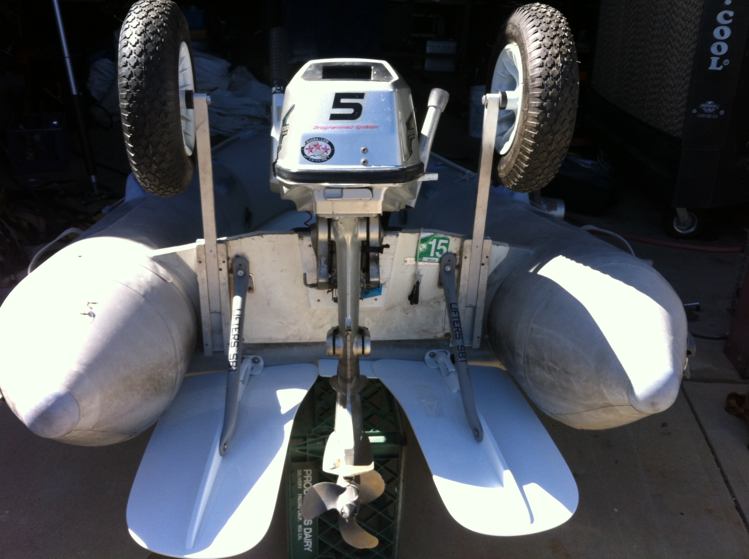

I have a 5 horse Honda and 6 hp Tohatsu. I like the 6HP better. Both will plane with trim tabs installed. Will not plane with weight over 425lbs. Hard bottom.
​See picture. Tabs were best thing I ever bought. about $100.
Chuck Lennox
97 MKii Ventura Ca
Island Girl Hull #1611
Image icon IMG_3827.JPG1.35 MB
Tell us more about the tabs... were to purchase brand...
clennox's picture
clennox
Joined: 3/31/14
Posts: 212
www.maximarine.com/products/lifters/
Maximarine lifters. Made a night day difference in handling and getting on the plane. Couldn't plane with one person and 6HP. Better mileage too. Takes about 1 minute to put on or take off. Seemed kind of cheap, but I have been using them for a couple years with no problems.
Looks like they are $114 dollars now.
I do have to remove them to put wheels down.
These things enabled me to plane without dealing with a heavier engine.
