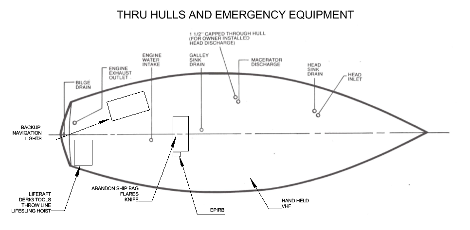

A relatively new requirement of some races is a notification of emergency equipment, to be displayed in a clear and apparent position. I think the intent was "where do you keep the flares" but since thru hulls are often a source of emergencies, I added those to the document that's displayed on my boat. The image is attached.
