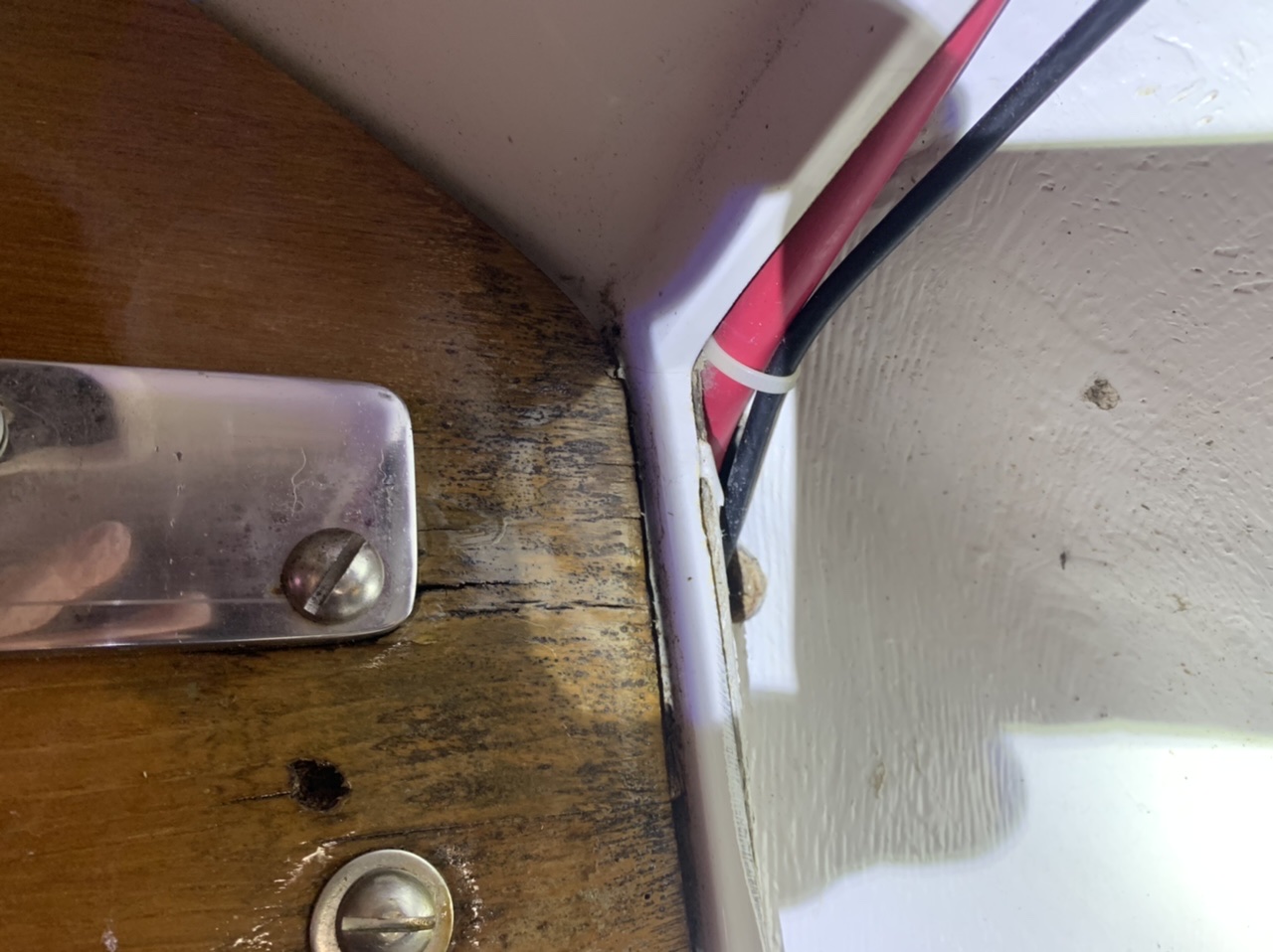

Hello All, I'm looking at the purchase of a 1997 C36 MKII. Everything looks pretty good after a personal inspection with the exception of a few concerns.
There has been the typical intrusion at the port and starboard forward bulkheads. At the top of the chainplate reinforcement strap they have dug out the bad wood and looks like they have filled it with epoxy. See attached pic. The port side bottom show water intrusion but the wood seems solid when poked with a dental pick. The starboard side bottom under the cushion is rotted. Pick goes in 1/2" or more. I've read the write up about replacing the port bulkhead. Very well done. If nessassary I can replace. Has anybody replaced the starboard bulkhead and how hard is it compared to the port. I did find the post about GitRot and that is an option for the botton. I don't find any soft spots going up either side of either bracket.
What is your opinion of the top repair job. Is it satisfactory or does it ned to be replaced?

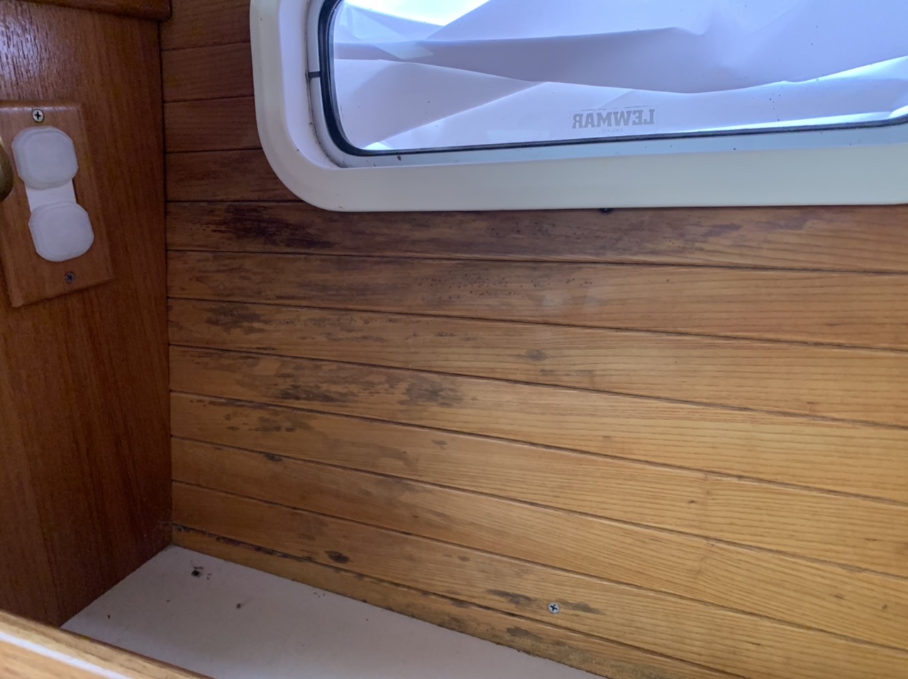

The other area of concern isthe port window between the cabinets over the settee. There is water intrusion there. I'm sure it needs resealed. What concerns me is the wood is soft and pushed out. You can push it in about 3/16". The wood can be replaced but what is behind the wood? Is this more detrimental than resealing the port and replacing the wood?

The surveyor will steer you to the things that you need to worry about.  Make sure he/she brings a moisture meter.  If you're in the north hold off on the survey until it's warm.  The moisture meter needs a certain temp to be effective.  The dreadful stuff is probably something else, the surveyor is key.  My doors all behave normally on the cradle.
