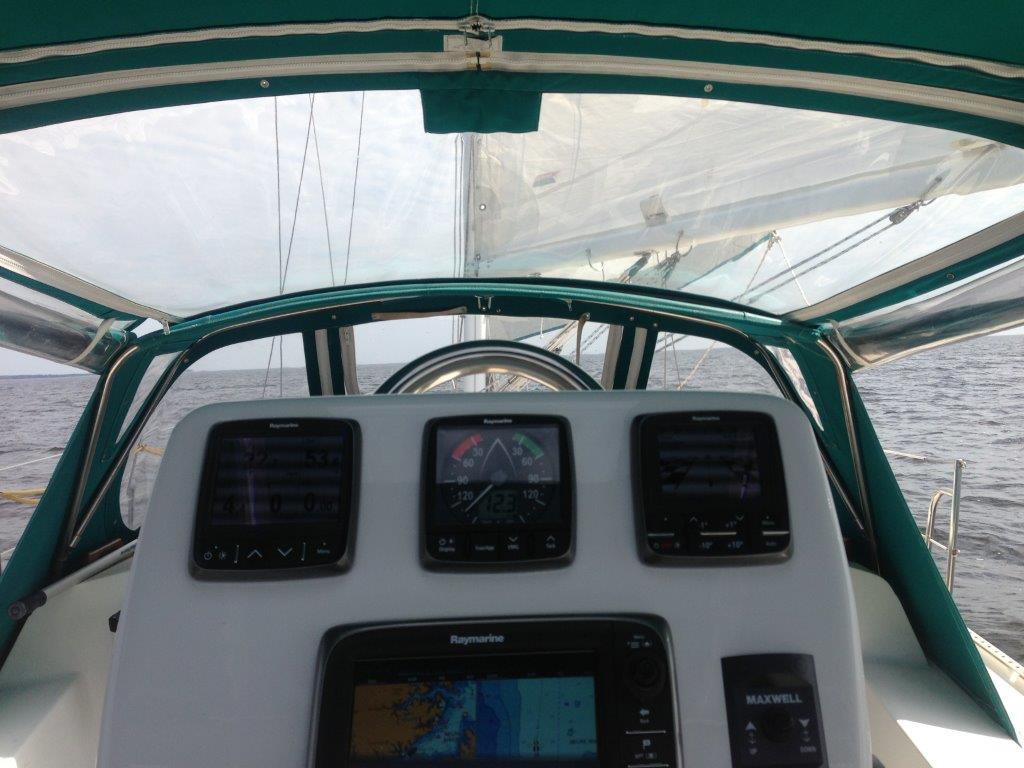

I replaced all the 1993 electronics on Serenity 2 years ago with Raymarine i70, i60, p70, x5 Autopilot and an E7D with sonar. Iuse the sonar for anchoring and channels that are skinny. Very happy with the Raymarine stuff.
PS: The integration from the E7D to the x5 wheelpilot is VERY nice!
