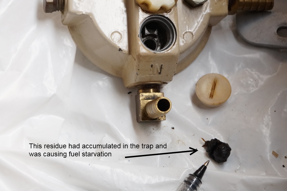

Posts: 461
Hi all,
I purchased my 1999 C36 10 years ago with 540 hours on the engine. Today it has 1300 hours on its display.
I have used it regularly, at least twice a month. I sail from San Francisco to Santa Cruz at least once a year and in most cases this 240 mile round trip turns out to require 75% of the time to just engine, due to low or no wind, usually when going back to north. Each 120 miles takes about 20 hours.
Currently my boat is in Santa Cruz as on the way back I had to deal with 8 to 10 foot waves and 40 knot head winds. So engining was the only way to move. Half way to Half Moon Bay - about 30 miles North of Santa Cruz, the engine RPM suddenly dropped from 2000 to 1000 and I heard loud pounding noise from the engine room. So I dropped to idle speed and placed the gearshift to neutral. The engine continued to run in neutral. So I reved up to see if the engine was having trouble - it reved up with no problem. Then I lowered to idle RPM and placed in forward gear and it started to moved forward. But as I increased the RPM to 2000, it started with the same loud knocking sound. Since the wind was blowing south I decided to return to Santa Cruz by raising the main at any way that I could.
I found that I could use the engine to propel the boat as long as I kept the RPM below 1500. I was able to re-enter the harbour and doc on my own power.
Today I went back to find out what I could find wrong. I ran the engine and heated it up to normal 160 F then put it in gear and reved up the engine to 2000 RPM for over 10 minutes.
The only thing that I noticed was there was blue smoke coming out of the breather tube - a light amount. I never heard the loud knocking sound. Everything worked as normal.
Interestingly enough today I found this post about the fumes coming out of the breather tube.
So what is the expected answer? Blue smoke spells trouble? I checked the oil level and it was normal. I am thinking that it appears to be burning oil. Or is this normal. If I could guess I would have to add one quart of oil per 2 months. There are no oily regions near the breather tube as the nearby air filter sucks the smoke in.
A white smoke would mean steam - I would think it is evaporating the moisture in the oil and it will stop when warm.
Has anyone observed their engine under load at 2000 RPM? Is there blue smoke coming out of the breather tube?
I am 120 miles from my home port. I would like to be able to engine back home where I can get help. Is it likely that I will be successful?
What are my choices?
I am also thinking that the engine may have been operating at heavy load and it could no longer handle the load due to large waves and high wind. The water temperature was always normal.
Thanks for your feed back.

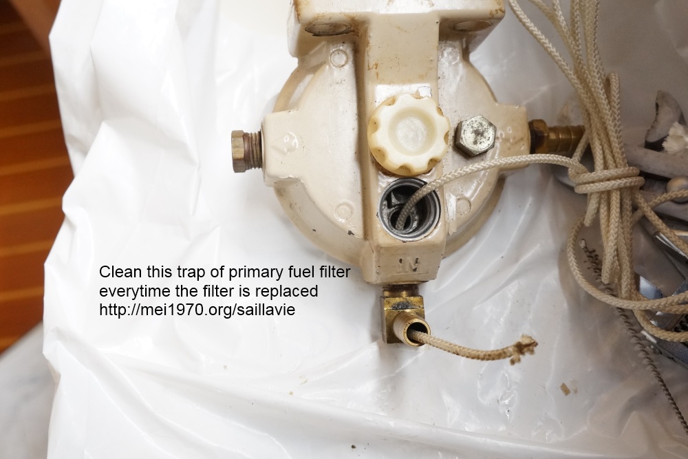

Posts: 720
Unless you are consuming oil (blue smoke out the exhaust) or blowing white smoke out the exhaust (antifreeze/water), I would tend to think the engine is OK. Loud banging can be caused by a fouled fuel injector, or bad fuel (among other things). How does your fuel look? Any water and algae in the separator? Sometimes an injector issue will resove itself or be intermittent. Powering through rough conditions can break free sediment and contaminents in the tank.
Posts: 461
pkeyser - you were correct about stirring up the crud that caused the blockage and fuel starvation. I was able to clean the residue that was accumulated in the trap under the primary fuel filter bracket and it is all OK now. The breather tube light smoke was normal.

Posts: 611
Referring back to Haro's pictures, I was sailing into a harbor a few years ago when the RPM dropped suddenlly (but the engine didn't shut down). The RPM's picked up as I jiggled the throttle but then occurred as I approached the mooring. I changed the filters and the engine seemed to run fine but then, after about 4 hours of running, completly shut down as I was going through the Race.
I hadaan engine tech look at it and of course he expected the filters to be clogged.... they weren't  so he took the whole primary unit into the shop. The problem was in the 90 degree bend of the fule input line into the filter. It was clogged as per Haro's pics. He cleaned it out and I didn't have any problems after that but I draiined and cleaned my fuel tank that winter and it did have junk in it until it finally built up enough to clog the fitting BEFORE the fuel got into the filter itself.
I heartly endorse Haro's suggestion of cleaning out that connection when you change the filter! I ended up changing the fuel line when I cleaned the tank and I used extra hose so I could cut a little off each time I disconnected the line. It's sometimes hard to get the line off the coupling without slitting the end so this allows me years of snipping the end.
