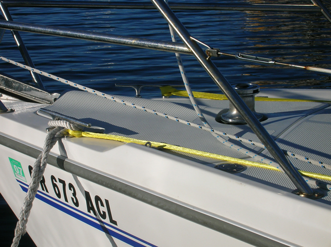

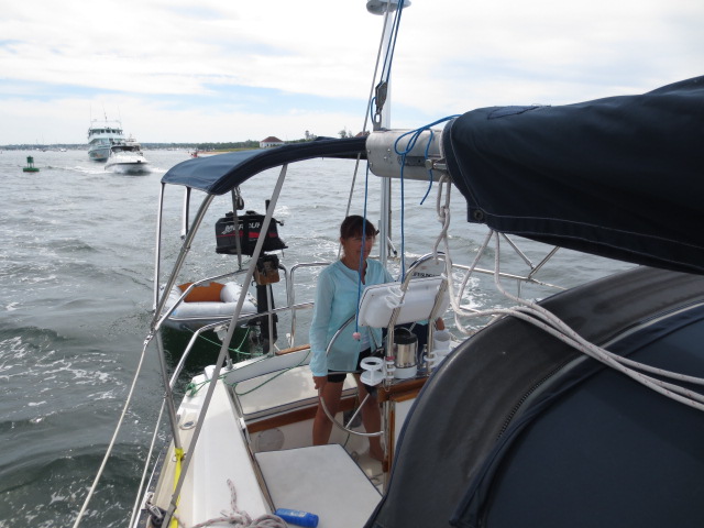

[QUOTE=SailorJackson;14298]On my prior boat I made jacklines with 1" webbing purchased from REI. This time I just purchased the premade jacklines from West Marine. .[/QUOTE]
I use 2 of the ready-made West-marine jacklines; if I remember correctly, they have a 30' line with loops on either end. With one end secured through the loop on the base of the aft-most stanchion, its a nice snug fit on the anchor cleat at the bow. (Our setup happens to show up in the attached pictures we took yesterday while sailing off of Block Island, RI)
Here's how I rig them.
FlyMeAway
Joined: 3/20/12
Posts: 241
[QUOTE=LCBrandt;14464]Here's how I rig them.[/QUOTE]
Thanks Larry.
I have seen this setup and I can't figure out how it works in practice.
The problems seems to be, if the jacklines are inside the stanchions, when you fall overboard you are trapped forward of the stanchion immediately aft if where you fell, with all your weight (dragging behind the boat) on the lifelines. Depending on the length of your tether and how exactly you fell overboard, you could find yourself dangling face-first over the side of the boat, possibly with your face in the water. This seems like a really dangerous scenario for a number of reasons, not to mention an easy way to mangle your jacklines.
If the jacklines are outside the stanchions and the lifelines, then a fall overboard will cause you to flow backwards alongside the boat until you are at the sternquarter, where a recovery seems easier.
I guess it depends on what you want to happen when you fall overboard: I'd be inclined to think a clean break, followed by recovery, is preferable to a situation where you could be trapped.
Am I missing something?
David
s/v Portmanteau
Hull #2133 -- 2003 MKII
Seattle, WA
