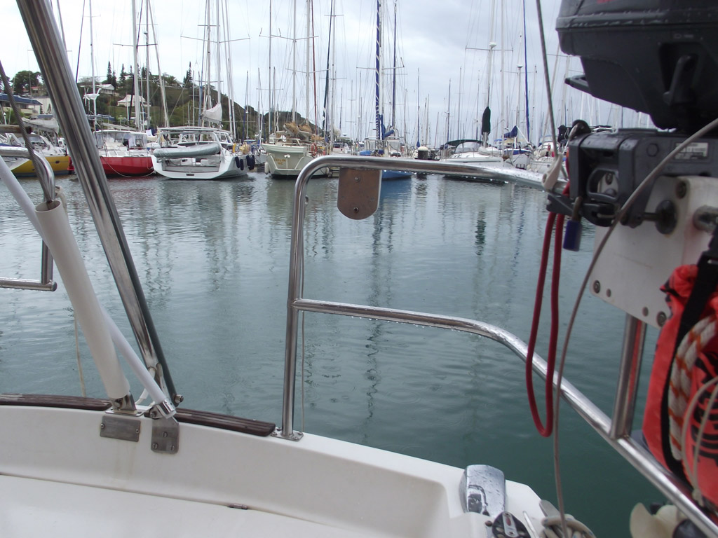

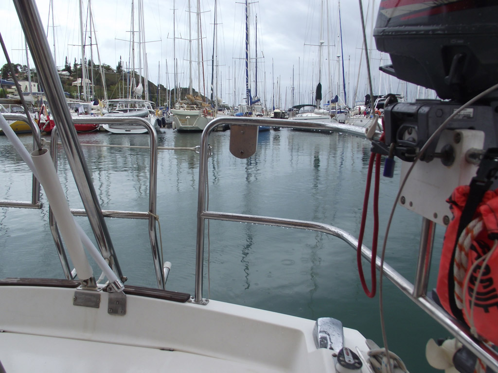

My 10 cents worth...
We found the access over the transom from the swim ladder quite awkward, so this year we made a poor man's solution, we cut down the pushpit so there is a bit more space...
We have a radar pole up the aft stay, so that limits things somewhat.
There is also an extra vertical to mount the outboard mounting block.
Works well, nothing like a walk thru transom but an improvement none the less :-)

Rob, that's a neat idea! Here's another one you may want to try: We originally had a fixed split backstay. I kept hitting my head on the splits! I raised it a few feet and put a Garhauer vang on it to make it adjustable. Don't hit myself on anything anymore.

Rob, thanks for the great idea! I used your photos to create an article for the homepage and the Technical - Upgrades library.

Thanks, Larry. We only did one side but it works well - especially when we are loading supplies aboard, or climbing over in swim fins :-)

Here on land I'm befuddled. The pushpit design on the MKIs seems totally different in the two sets of images, even before the mods. Images here:
[url]http://www.c36ia.com/node/2209[/url]
seem to show horizontal rails coming around with a single vertical support at the end.
Rob, did you really take out the vertical support at the bottom? That's what you mean by you only did it on one side? Doesn't that reduce the strength of the starboard side?

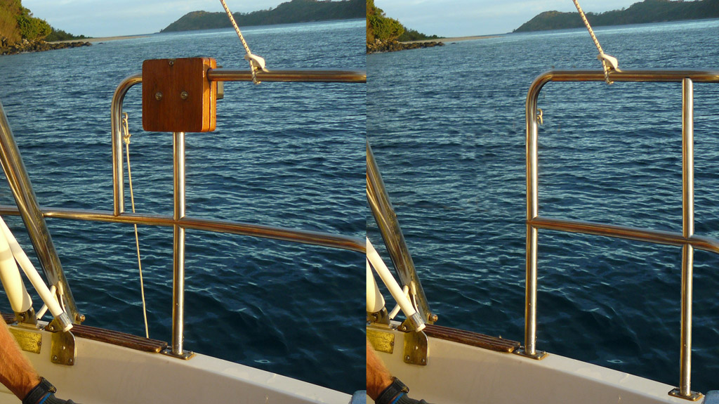

Hi there, sorry for the delay replying - we've been out of Internet range for a time
No, the vertical post remains, but the overhanging upper curved bit is moved to the port side by about 5" and the middle rail that was continuous across the transom is cut flush with the verticals and plugged.
It seems quite strong enough, not wobbly at all.
Edit - attached is a photoshop I did when planning the mod - original set up on the left of the photo... In the right half it shows an extra vertical, but in practise we found this was not necessary so we didn't put one in.
