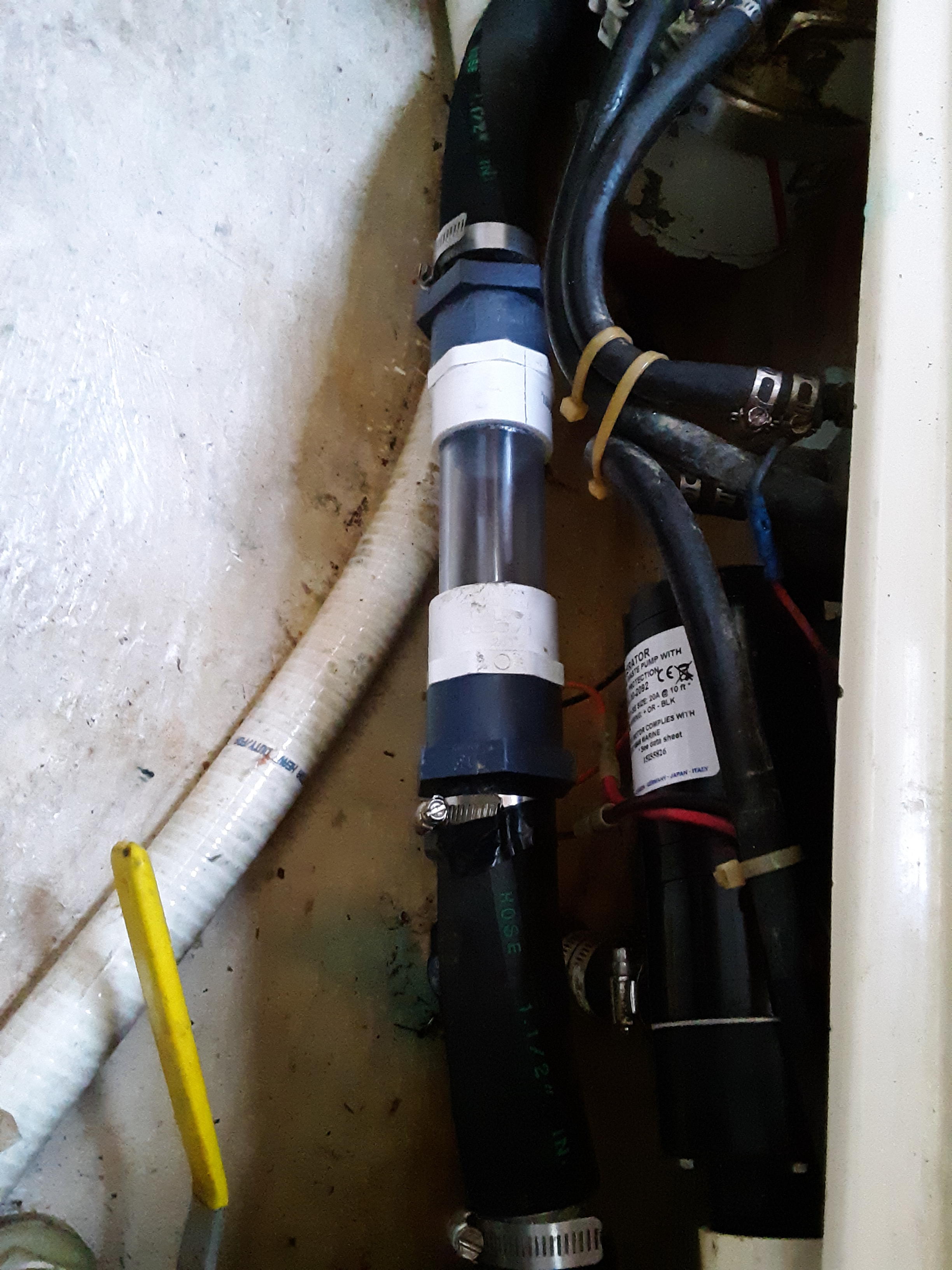

While I'm on the subject: A few years ago we added a short segment of clear tubing to the line running to the macerator pump, so one can visually tell once the pump has done all it can do (many times we've seen these on the pumpout hoses as well). Another member had posted this idea (if I could recall I'd give her/him credit due). Attached is a picture of the installation -- takes some of the guesswork out of this.
