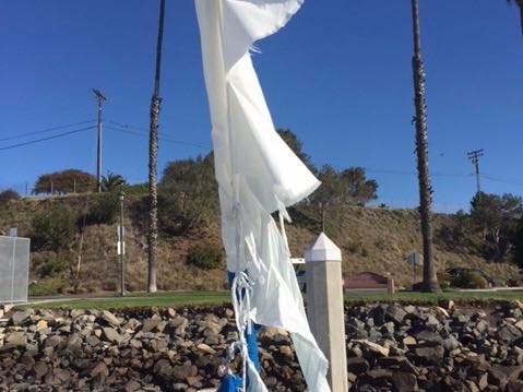

So, the 50 MPH winds that hit Marina del Rey this past Sunday managed to somehow partially unfurl my headsail and proceed to rip it pretty badly. Because the sail is at least 16 years old, I've decided to buy a new sail rather than trying to repair it, so I need some advice. I'm not sure if it's a 135 or a 150, but I can drag it out and measure it. Since I have never bought a sail before, I'm thinking I should stay with a local sail loft rather than buy online. What do you think of that idea? UK has a loft nearby, what is the general opinion of UK sails? I mostly just day sail in the bay with the occasional Catalina trip, so I don't need a high tech racing sail. I am a bit lost in this process, so I would appreciate ANY opinions including other sailmakers I may not know about. You're help is appreciated.
Thanks, Mike

Welcome to the club, we had 68 kts in Ventura and my sail is toast.
I'm going with a 135 up here in Ventura. If I was down your way I'd go with a 150. 155 if you race. Be sure to measure the bolt rope length. I found out that I have a tall rig and didn't even know it. The tall rig sail is 45ft 8 inches (Luff). Standard is 44ft**. My sail's foot measured 21.8Ft around a 140-142 sail.
On a side note: I don't know what I did wrong? The sail didn't unfurl. It just seem to suck the sail up high out? The clew and sheets were still intact and tight. Maybe I didn't have enough tension on the sail when I rolled it in.
Another side note: Super pain in butt to get sail off the furler. Had to cut sail up. If this happened at sea it would be a major problem.

I thought it was just us. Sorry to hear that others suffered the same head sail trauma we did. The winds came through Oceanside with sustained winds over 30 knots and gusting to 65 knots. Our roller furled 150% Genoa did not make it through the night. It too was rolled up OK with three wraps of the sheets snug around it. Furling line tight and tied off. We went to the marina that afternoon and made sure all was fit for the night. Like Island Girl, Pelican did not unfurl her head sail. It seems to have just slacked itself in the middle and set to tearing itself apart. Very difficult to get off the head stay. I too wonder what exactly happened, what I did wrong and how to prevent that from happening again. Maybe the collective knowledge here at the Forum can help explain. Our sail was 4 years old. I loved that sail. We are having the Elliott-Pattison loft make us a new one.

I have the tendency to wrap my genoa tight by holding the genoa sheet as I furl it in. For the most part I dont take any wraps around the furled sail, but I do wrap both sheets 3 times around each  winch and cleat off. Basically this keeps forces in balance and opposed. I know this arrangement has survived up to 60 MPH gusts. Also I am on a mooring all the time and not tied to a dock, which could be a factor in your case.

I would characterize the furling of the sail as pretty snug, but not quite as snug as I could have made it. Finished with three wraps of the sheets around the head stay. I think you are correct in suspecting the sheets not being tied off causing all the trouble. Under normal conditions we stow our sheets forward in a bag tied to the bow pulpit to keep the deck clear while we are in the slip. I think next time, for these conditions, I will keep the three wraps and rig the jib sheets to create tension against the furling line keeping the sail snug to the stay. I was quite confident the boat was ready for those winds. Lesson learned.

Got your PM, Chuck, and thanks. Mine was the same. Furling line secured, sail wrapped with a few turns of the jib sheets and secured. All I can say is "Duh". Mine was also so twisted it was hard to get down, complicated by the fact that the wind tweeked the extrusion to the point that it displaced a rivet so the swivel would only come down halfway. Had to have a rigger go up and clear it. Boats are so much fun. :-)

We always take several long wraps with the jib sheet. The sheets then end up near the deck where we cleat them off to the bow cleats and coil the rest hanging on the bow pulpit. This clears the deck, no sheets to stumble over as you do other things on the deck. If winds are forecasted to be 60+ then it is prudent to remove the sail. The windage from high winds can snap the roller furling extrusion even if the sail does not unravel. This occurred to a close friend whose head sail survived IKE but the extrusion failed and he found that out at his next sail where he was offshore preparing for a race start.
