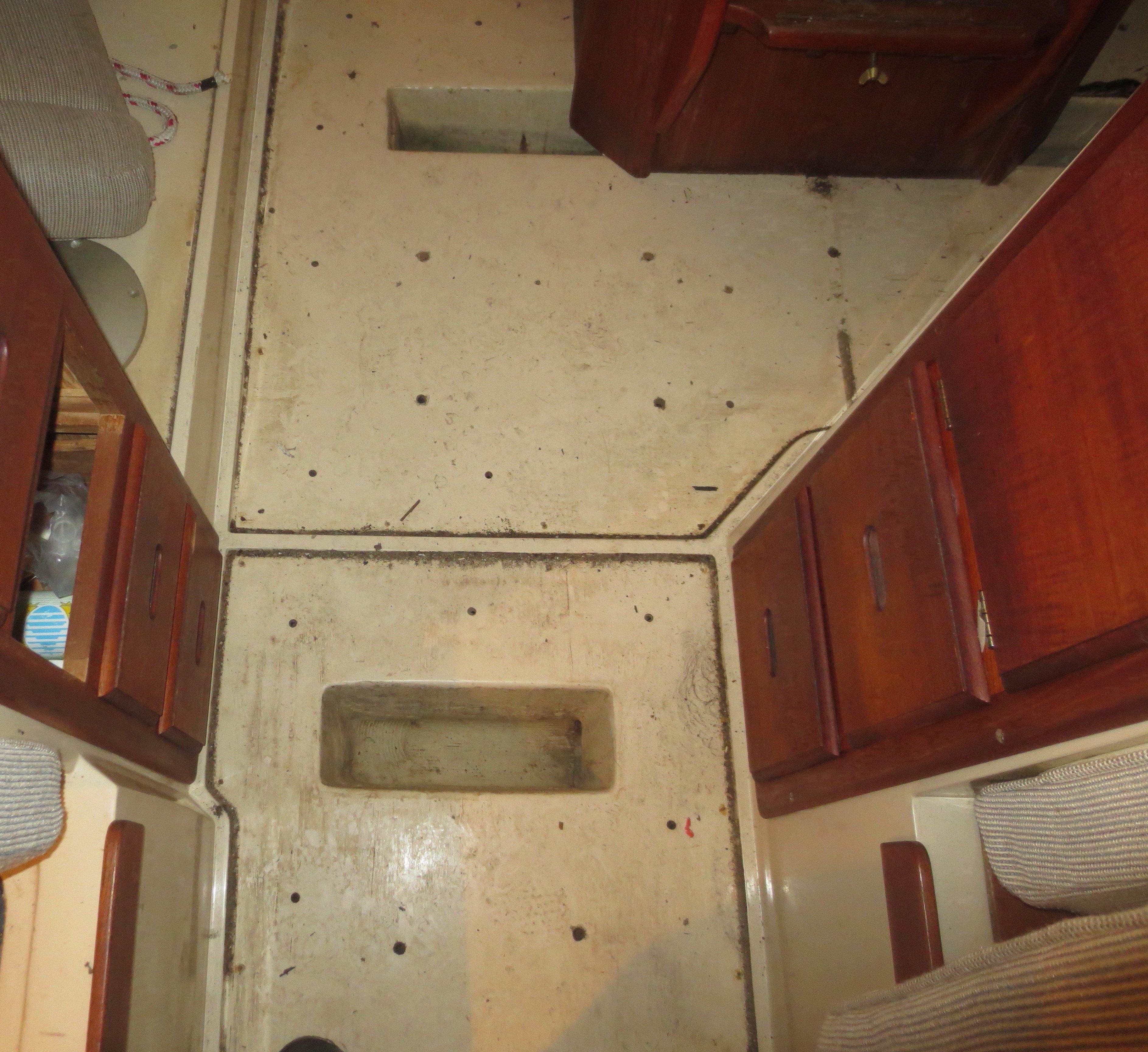

If its of any use, attached is a photo from a few years ago when I took up the old floorboards to replace them, showing what's underneath in part of the galley area.   As you can see, there are some various "pockets" in the subfloor, perhaps the sole has rotted and is sinking into them?

Thank you both for your suggestions. It is definitely not the wood. The teak and holly is in excellent condition. This problem is in the fiberglass. It's like the compression post is pushing the sink cabinet downward. If I knew how I would include a picture but being an old guy I'm Technologically challenged.

James -- It would be helpful if you could post some pictures; its a bit hard to visualize the issue.
As I recall (we sold our C36 last fall, so this is all from memory, and thus may not be reliable!) there was just mostly open space below the floor pan in that area between it and the hull (when I was working to snake cables and hoses through there).  If the floor pan failed in some way, probably would need to glass in some supports.
