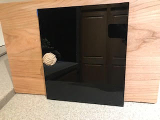

Same issues.  Little winter project. 1998 36 MKII.  I purchased  1/8" - Black Plexiglass Acrylic Sheets from estreetplastic.com.  I cut a piece and took them to Amoore and it fit and slid just fine. Looked great. Strudy, better than the old tan vinyl sliders. Should not warp.

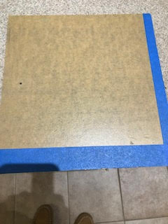

I placed painter tape on the lines where I would cut the sheets. Traced and measured then cut them on a table saw with a fine blade.
The old pulls would work but plain.  I searched the web could not find small nautical pulls.  I found small monkey knots on Defender, $12 for 2.  Looks great against the black and the galley cabinets.

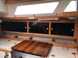

As a follow up to my March 23 note.  I was finally able to completed my project on the Galley Cabinet doors.  See the photo.  They came out nice, at about a cost of little over $100.  Black plexiglass from Estreertplastic and monkey knots knob from Defender $13 for a set of two.  Easy to do!
