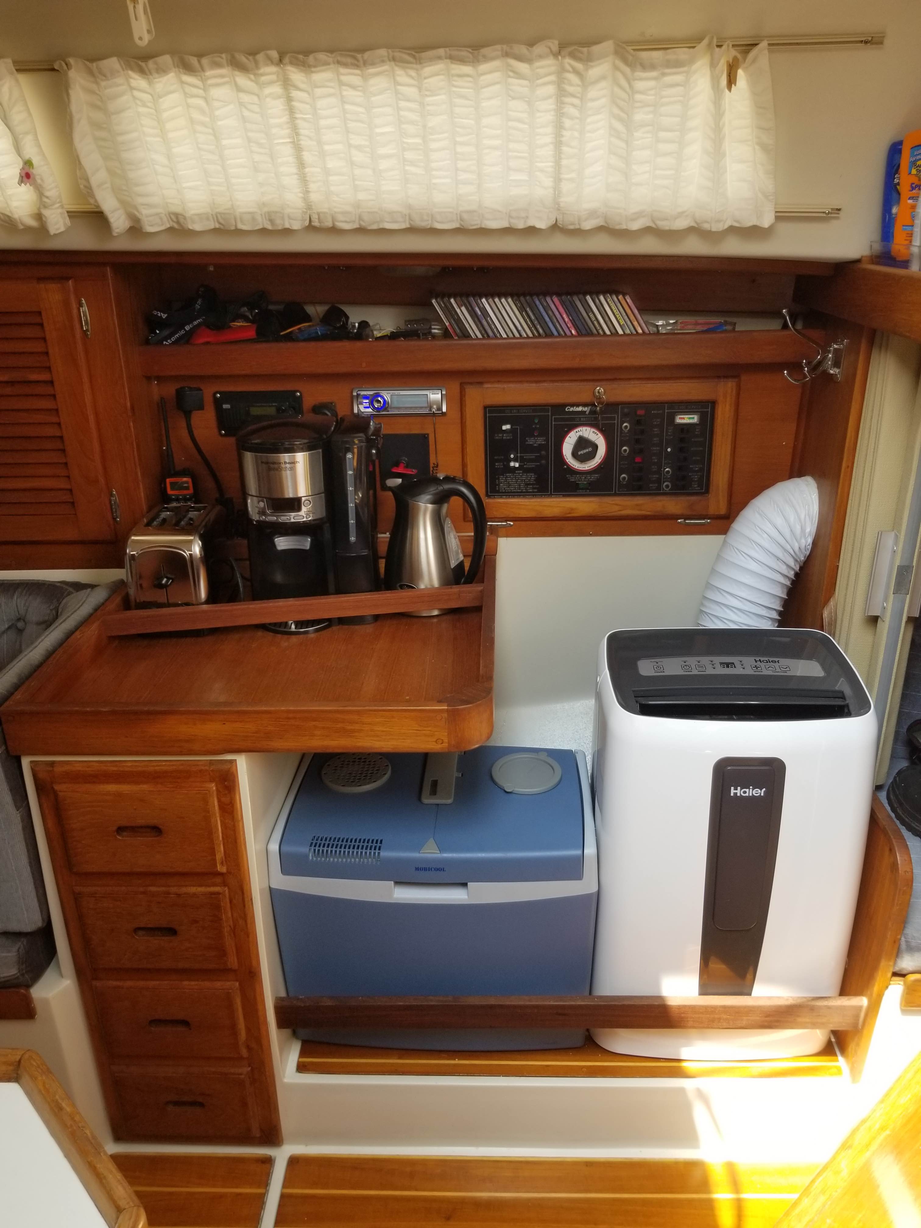

Posts: 258
Please see attached photo below.  The 12 v chip burned out in the blue cooler after a couple of months, but I replaceed it with a better insulated non-electrical cooler with a drainage plug.  I then attached a tube to it, ran it down through a hole I drilled in the floor and into the bilge.  I put a bag of ice from our on-board ice maker and the layer of cans at the bottom are super cold.
