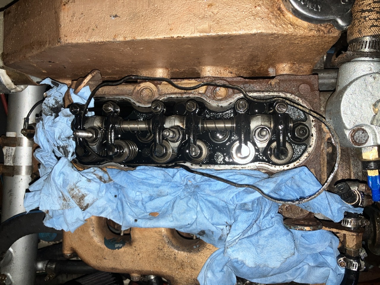

I have the heads off my M-25 now. Here is a pic without the valve cover.
David
Mobile, AL
S/V Beach Belle
1983 Catalina 36 Mk I #154
Std. Rig, Fin Keel, M25
