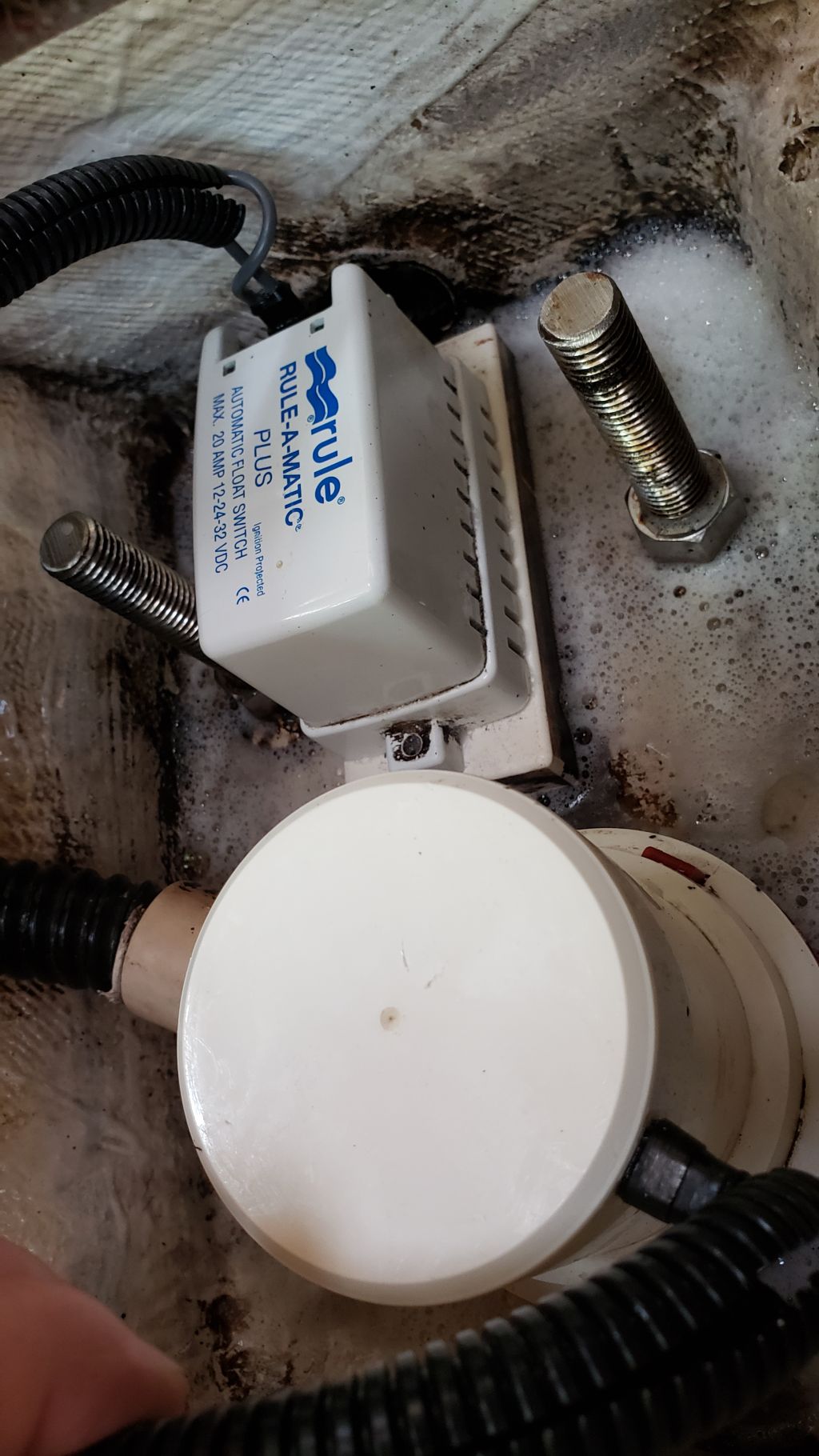

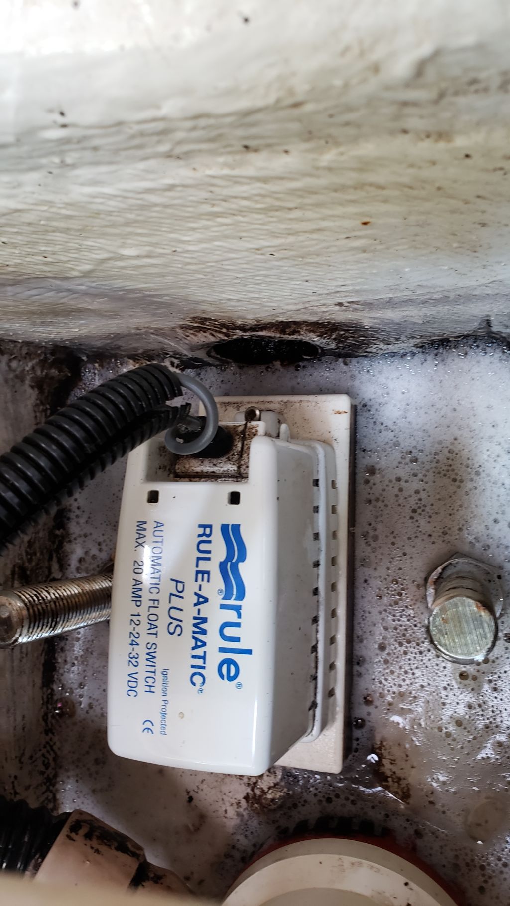

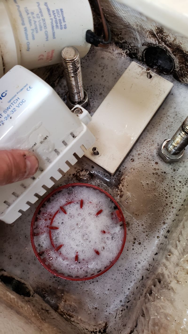

I've had the boat for a week, still trying to figure out what is a "normal" level of water in the bilge.  I know I've read about this subject on this forum before, I remember it being a bit contentious, with one camp saying there shouldn't be ANY water in the bilge, and another saying there will most always be water in the bilge.  I have in-mast furling and our spring here in the Northeast has been quite soggy, so some rain water is to be expected.  But I pumped out a half a bucket today!
Today I removed the pump and float and cleaned them both thoroughly.  The float switch is working fine.  One of the problems is the existing float switch requires quite a high water level to activate.  This is partly due to the fact that it is sitting on a piece of 3/4" starboard block (see pics), so it is already fairly high off the bilge floor.  One of my projects this summer is to possibly swap out the float switch.  The PO provided me with the one that he intended to add (in my hand in the pic), I'm hoping that since it's lower profile maybe it will kick on at a lower water level.  Wondering if anyone has come across this same issue, and if so what you can recommend?
See the attached pics, let me know ur thoughts!
Thanks (again)!
The switch may be one issue, but trust me on this: your pump will never be able to deliver a "dry" bilge, for at least 2 reasons. A) because if the switch was positioned and designed in a manner that would operate the pump until there was no water left, the pump would never turn off, and B) because once the pump goes off, there will be some backwash of water from the hose.  There are some clever designed with sponges and vacuum pumps that might to it, but not a standard bilge pump.
Suggest you take a look at Tom Soko's article in the upgrade section here:
www.catalina36.org/members/technical/upgrades/adding-second-bilge-pump
Similar arrangements are described in Nigel Calder's "Boatowners Mechanical and Electical Manual" and Don Casey's "This Old Boat".
We've duplicated this on our boat, and while it doesn't get rid of all the water, the way the drain hose for the smaller ("primary") pump is plumbed with a loop (as illustrated in Soko's write-up) greatly cuts back on the backwash (and the smaller hose helps as well in limiting the amount of water that flows back).  One still has the original (now "secondary") pump with a large hose size (and no loop) for when the perverbial excrement hits the fan and there's a lot of water to be pumped out in a hurry, activated by a second switch that is mounted somewhat higher.   I find this redundency very comforting.   In fect, we long ago made it a routine, as part of our "closing up the boat" checklist when we leave the boat for any length of time, to check the operation of both bilge pumps, and I've been surprised at the number of times I've discovered that one or the other pump was not working (a loose connection [it is a damp location], some crud wedged in the pump intake, a sticking switch, what have you).
Yes, there are members here who have acheived bone dry bilges -- I, sadly, am not numbered among them!

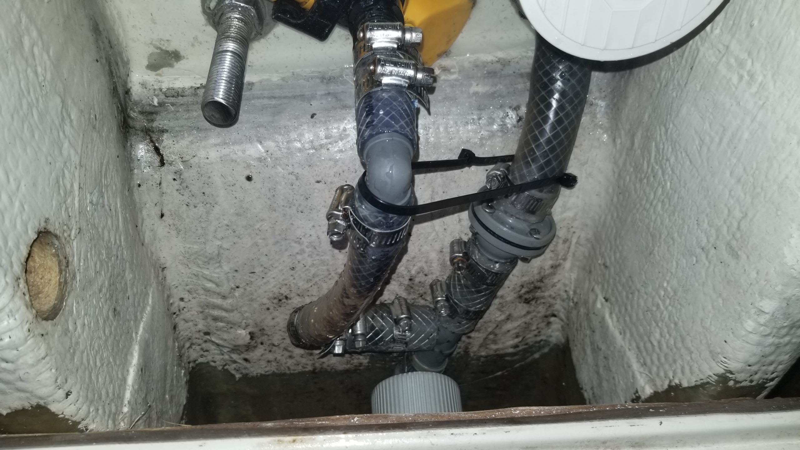

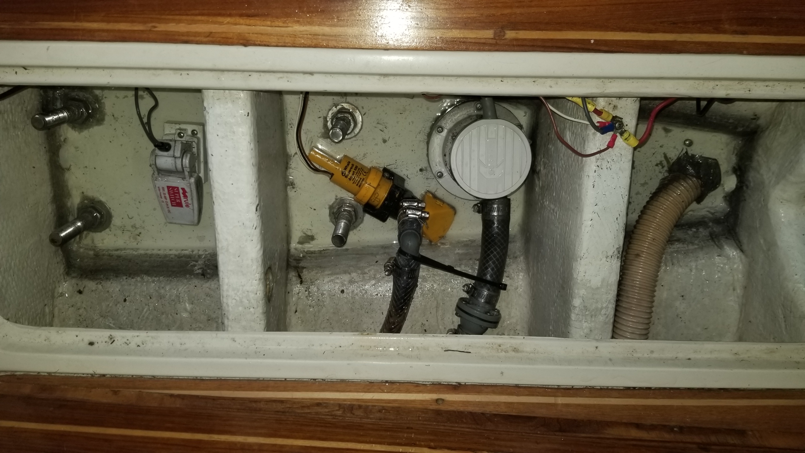

Great stuff, as always. I'll take a look at those links. A loop makes sense, but what about a check valve? Do they make an in-line check valve to prevent the back wash? And do you think the float switch needs to be up on that block? Thanks again.
The collective wisdom I've read both online and in the two books I mentioned in my prior post (which, BTW, if you don't have them I highly recommend for your library) is that check valves are not a good idea on bilge pumps, because they can occassionally get stuck (which would not be good when you needed the pump to be operative!).  This has been discussed before, and there are -- as always -- differing opinions: see, e.g. www.catalina36.org/forum/technical-discussion/bilge-pump-suck-and-fill .   Mainesail's comment in that thread I dound to be particular compelling.
As to the mounting of the float switch, I'll offer a guess that a PO did that because the pump was cycling on and off too often.  That was also discussed in the same thread above.

I think about 1 inch, maybe a little more is normal. I did install a check valve that I bought at West Marine and haven’t had any issues.
Keep sending your questions to the forum - Lots of knowledge sharing and great people.

I like the idea of creating a primary with a lower suction point, a smaller discharge hose and a loop. But, I am not confident enough to fill a hole in my new old boat and add a second discharge outlet. It's probably something better done on the hard anyway right? But I will copy that set up. Thx!
   Can't supply the confidence for you, but can supply some info:  The hull (at least on our MK1) is not cored (so you don't need to go through the process of digging out core material around the hole  and fillng with epoxy), and the thickness of the transom where the discharge mushroom fitting would be installed is actually suprisingly thin, so its not a difficult job, and certainly can be done while the boat is in the water (this is, after all, a discharge above the water line!).
  But certainly a job you can wait to do until the off-season.   You'll no doubt begin accumulating a list of things of changes/enhancements you'll want to do as you get more familiar with your new old boat, and hopefully a way of prioritizing them.

  • Sucking the bilge dry -- buy a Taylor Made Bazooka Bailer, 5' boat hook with pump inside -- super powerful, suck out and squirt into the galley sink.
  • Go for the low profile pump (I used the Whale) at the lowest point and the float switch mounted at a higher level on a piece of Starboard as your PO had installed.
  • I went for the SUPER SCARY one-way valves both at the large diameter hose from the large pump and at the Whale pump before it T-connects into the larger hose.  I used the inexpensive grey plastic ones with the rubber flap inside -- low chance of failure.  Stuck open -- no problem as the back wash just comes back.  Stuck closed -- I check their operation regularly both with switching on manually and running a bucket of water into the bilge by opening the hot water tank release tap and it is unlikely, but then I also have two pumps and two valves, unlikely both would fail... (hey, I'm a risk taker and NEVER close my seacocks!).
