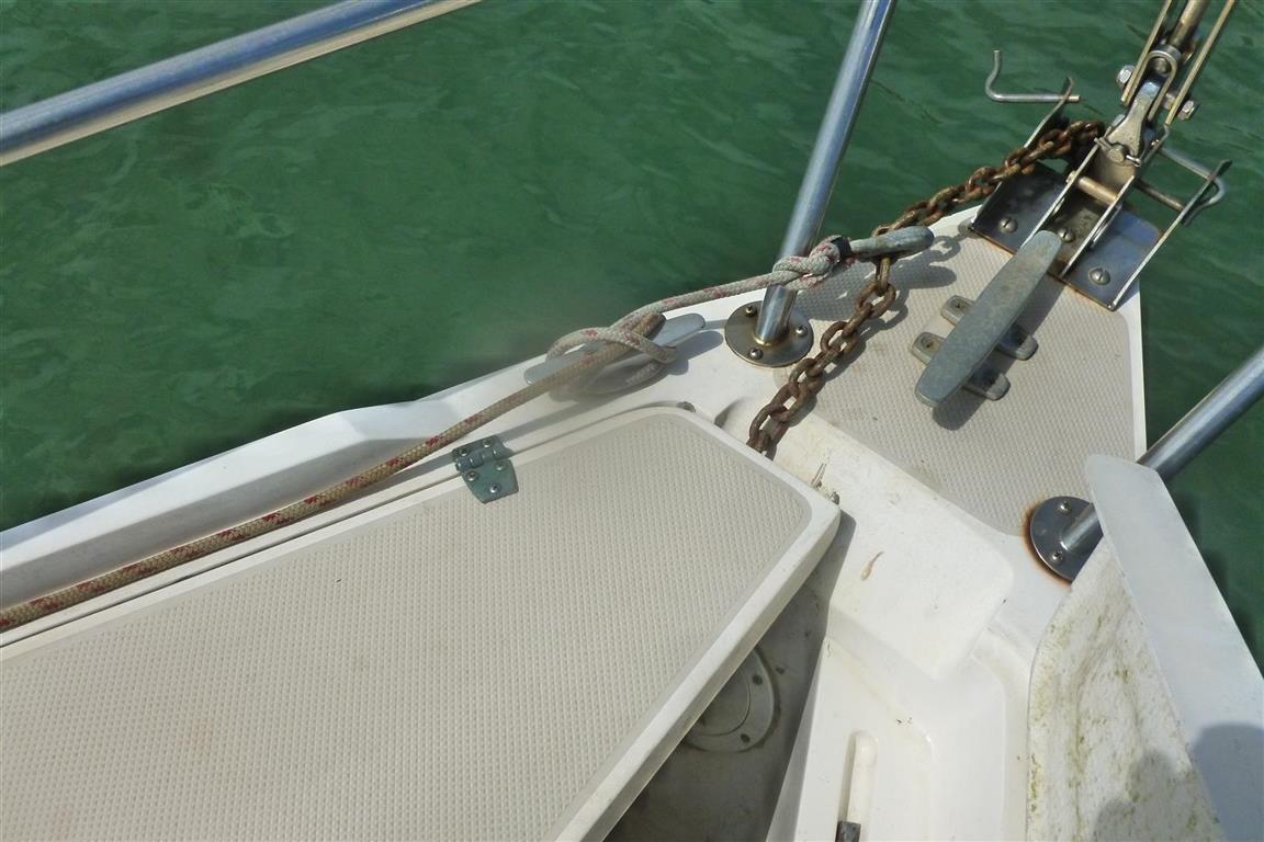

Many posts I have read, here and elsewhere, indicate that manual windlasses are slow and after a short period of time a PITA to use. You might want to search around, say on [url]www.cruisersforum.com[/url] about these.

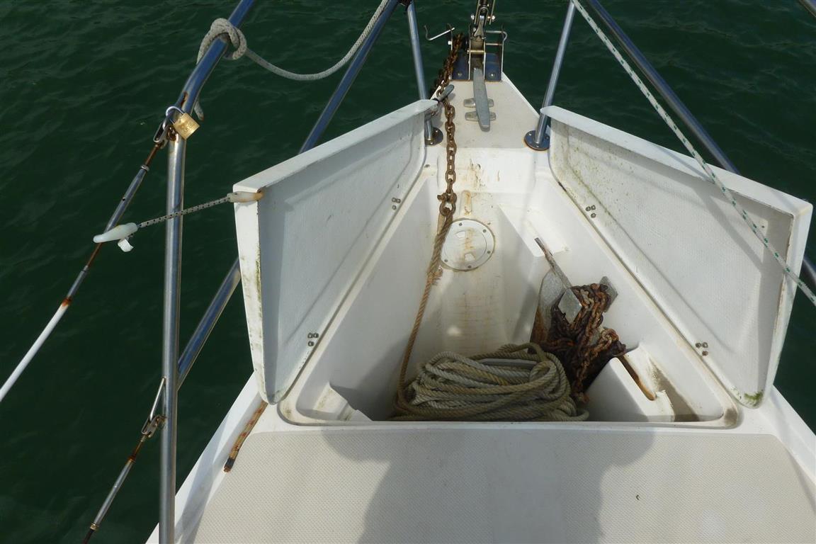

Chain stoppers: here's what I did - a short line tied to a cleat and then a chain hook. Works great, I anchor out every week.
Our PO also installed a simple hose hanger in the anchor locker. I find it invaluable to hang the rode (35 ft of 1/4" chain, 200 feet of 1/2" rode). Might not work if you have a LOT more rode. We generally anchor in about 12 feet of H2O.

I had originally thought to get a manual windlass. See my earlier thread on this, if you like...but (a) they appear to be almost as expensive as an electric and (b) you have to stand at the bow next to all the dangerous ropes and chains while operating it, so I gave up on them.
