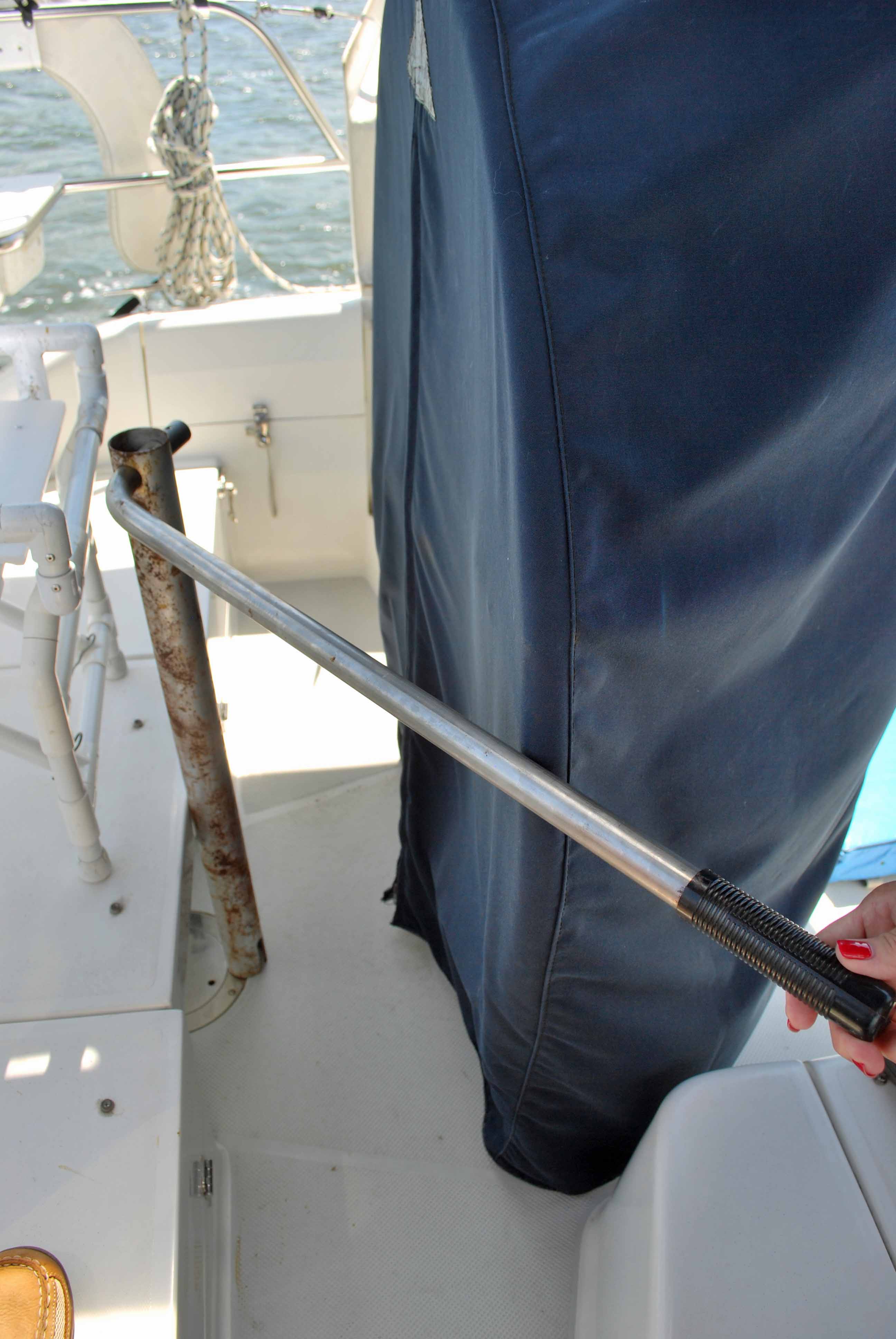

Here is a pic of my emergency tiller for a MK II. It came in a red bag marked "Emergency Tiller". I obviously have not had it out in a while and it has gotten a tad rusty. I didn't mount it but put it in the spot where it would be attached to give you some idea of the size. The pipe extends the rudder post up and the insert off to the side allows you to steer without removing the wheel or anything else.
Hope this helps. On my C 30 the tiller was a wooden tiller similar to what you'd have on a C 22 but shorter.
Image icon Emerg Tiller 1.jpg349.73 KB
Good picture Chuck.  BTW - I think your nails look really nice...  ;)

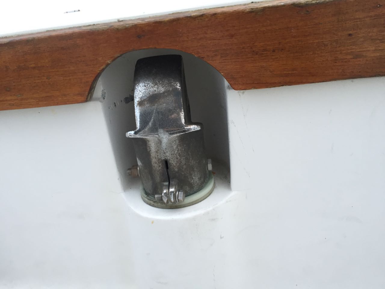

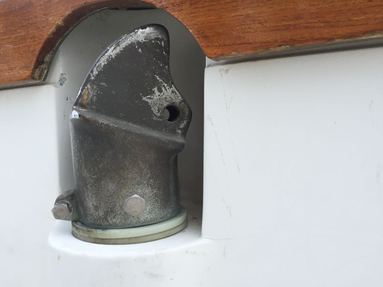

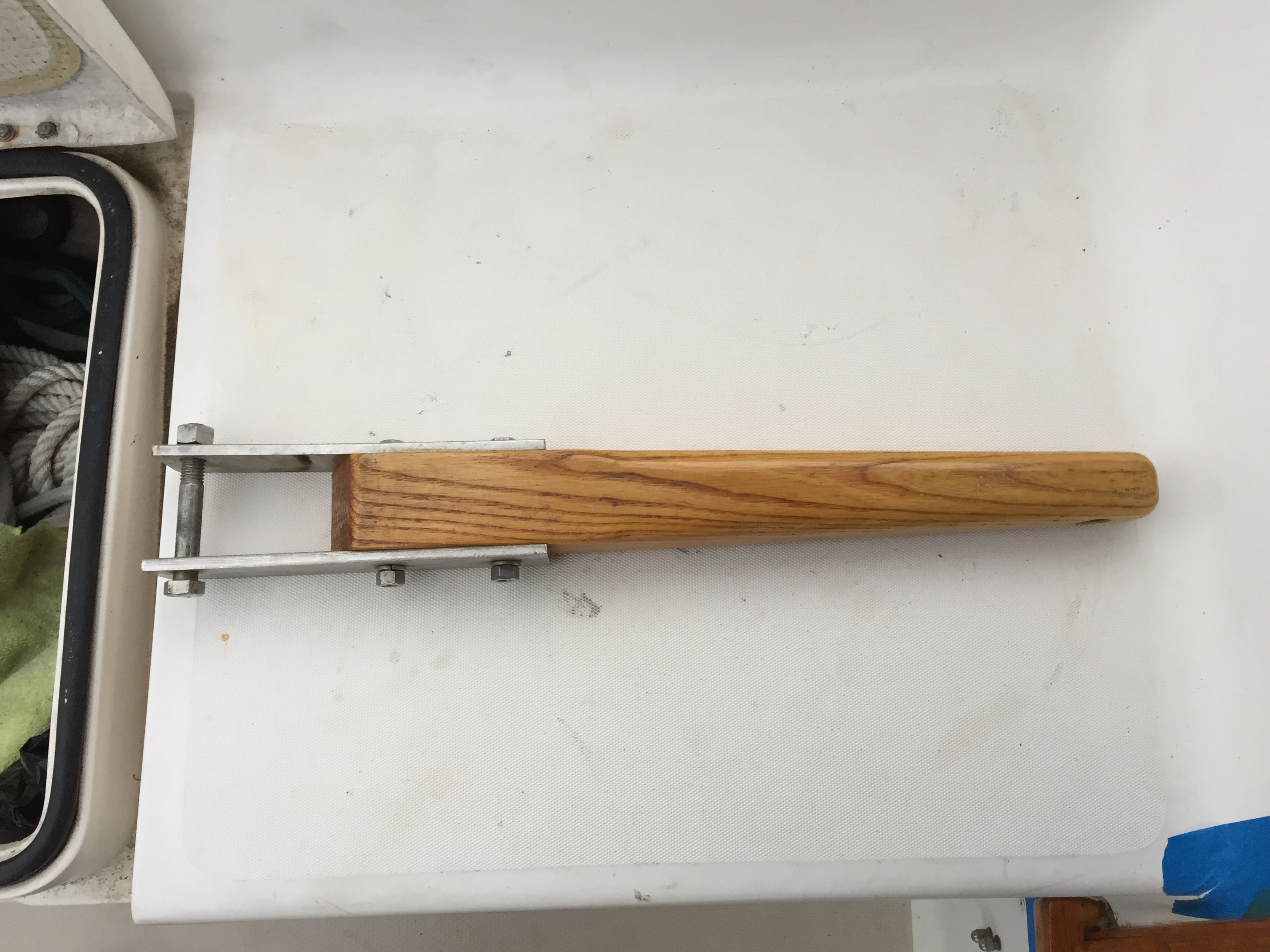

We have a 1983 MK I model. Here are photos of the emergency tiller that came with our boat.
Update Nov 2015:
I added 2 photos showing the top of the rudder under/in front of the aft locker where the tiller handle attaches.

I have that same handle. I have absolutely no idea how to use it.

AHA! Thank you for posting the pictures of the rudder cap raingolfer! Now I know that I'm not an idiot. My cap is entirely different. Must have been something the PO did (she did do a lot of mysterious things).

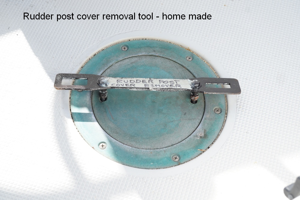

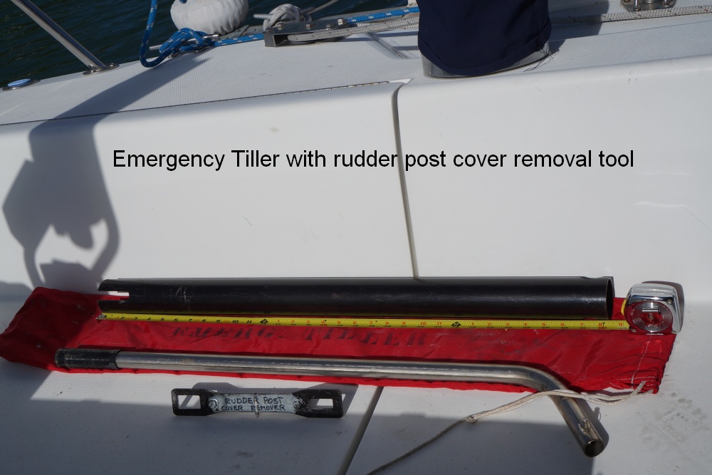

Here are 2 images of the one on my C36. It is 32" long and comes in a carrying bag. To make the cover removal easy, I made a handle for it. To keep the cover from seizing I use pipe thread paste on its threads.
I have applied Lanacote to the axel of the steering wheel and the threads on the holding knob and I make sure that it is free for removal. I keep a steering wheel removal tool on board in case the wheel will not come out.
