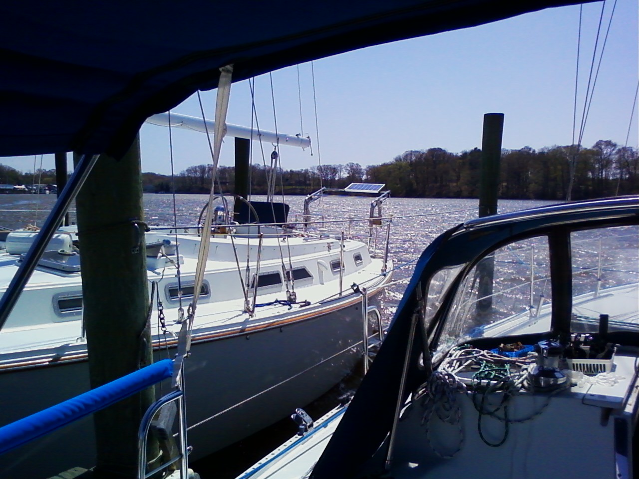

The attached pic doesn't show much of my slip, but it shows a couple things that make it much easier to dock. The slip faces roughly south. When this pic was taken, there were south winds 25-30 knots in my slip. It would be virtually impossible to back into the slip with that much wind on the nose, it blows the bow off on either side; so I'd come in bow first if necessary.
You can see 2 lines tied between the outer piling and the one at the end of the finger pier, by the lifeline opening, one high, one about deck level. These are pretty tight and serve to catch the boat and keep it from banging into my neighbors boats. My slip is oversized, about 50 by 20, so the boat can just about fit between the outer piling and the one on the end of the finger pier. When backing in with the normal, westerly wind on my starboard side, I clip a carabiner onto one of the ropes on the starboard side, then around a cockpit winch. That keeps the stern under control, while I go forward to handle the bow lines. Works great for me.
While I do have a spring line and a midship cleat that I installed myself, I only really use that when the wind is astern. I put the spring line on the cleat, wait for it to snug up tight (slowly), then keep the engine in reverse while I attach the stern lines. Once done, I can take the boat out of gear and tackle the bow lines.
Several of my neighbors have commented on how well I can get into my slip. I don't really think it's any special skill, just planning and thinking ahead. I've been honing my technique for some time and learned from my mistakes; if you make lots of mistakes, you learn a lot..!!! ;)
