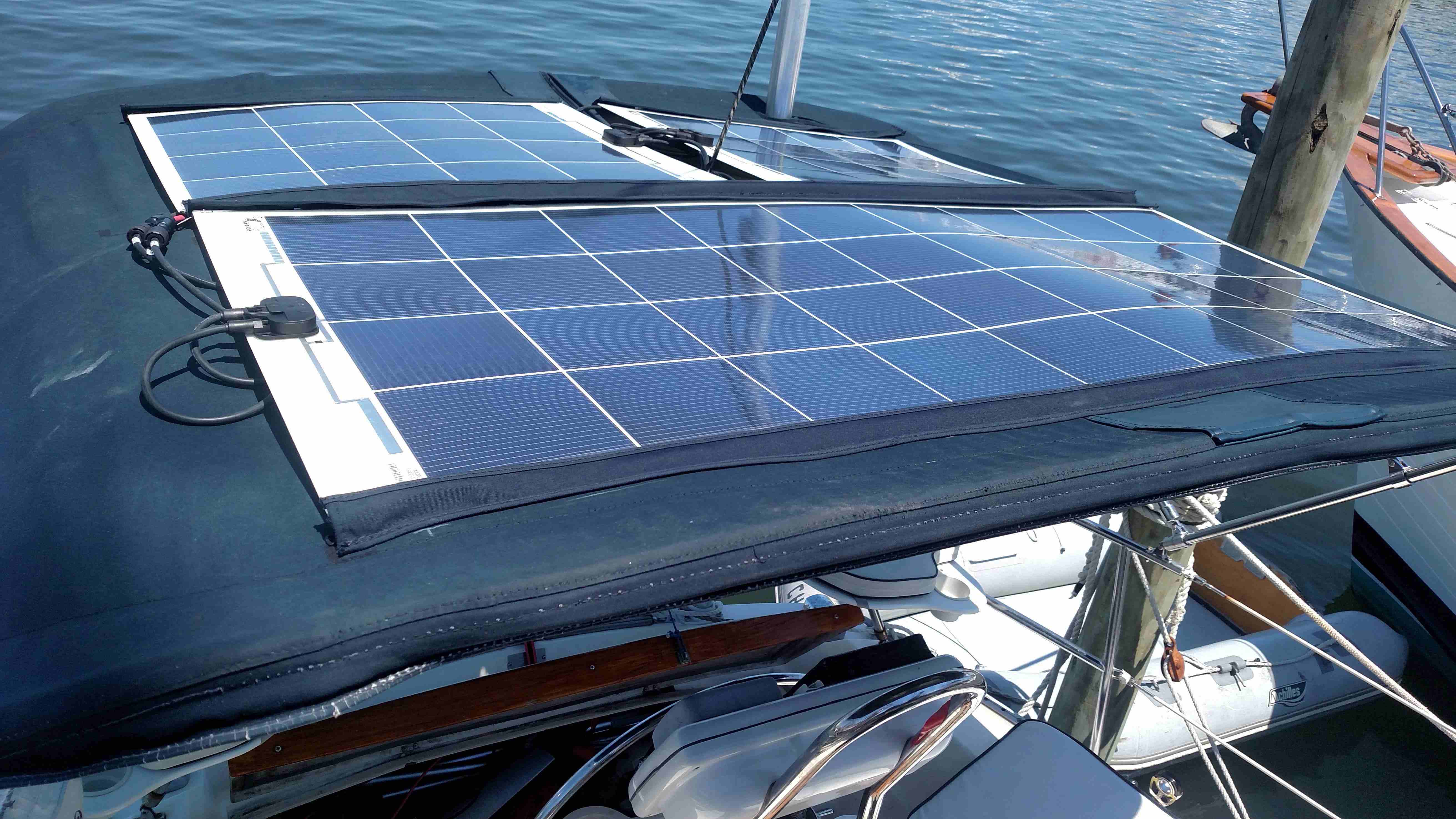

  We added 273 watts of solar power in the form of 3 Solbian flexible panels: 1 145W panel that lies across the front half of the bimini, and 2 64A panels that are on the rear half of the bimini (needed to do it this way because of the backstay which goes through the bimini; your MK 2 with a split backstay may not have this issue).  They are held on with zippers that were sewn on to the panel edges and the bimini (I was advised that velcro wouldn't be strong enough).   Alas, I had to sacrifice the opening flap window on the bimini in the process, but it was worth it. See pciture attached.

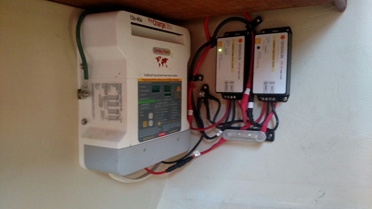

  The 145 W panel is wired to  a Genasun GV-10 controller, and the pair of 64W panels (128W total) are wired in series to their own GTV-10 controller; the outputs of the 2 controllers are then wired in parallel to the house bank (which is 220AH).  (They are located under the navagation table, as in the photo below, right next to the charger). This was recommended to me by the folks we purchased the panels from (Ocean Planet Energy, https://www.bruceschwab.com who were very helpful with consulting), as the panels had different outputs.
  We cruise in New York and New England in the summer, and have found that the panels produce more than enough to keep us sufficiently charged, even with the refrigerator running full time.  Indeed, it supplies enough power to also recharge our Torqeedo electric outboard (for the dingy).
  Mainesail (former C36 owner) has a good write-up on how to install on a bimini....https://marinehowto.com/installing-a-solbian-semi-flexible-solar-panel/

The pic is great.  Seems like you got the right amount of wattage for sitting on a mooring or making long passages.  Great advice too about not trying to span across any of the support poles.  Thanks again.
