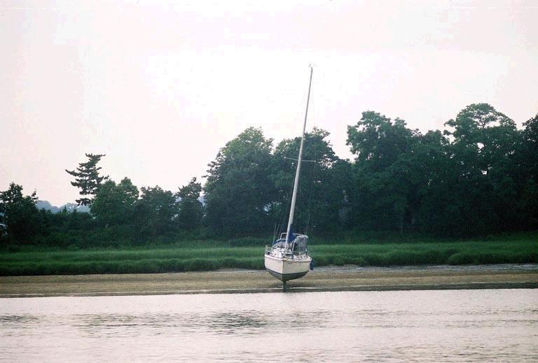

One area of the C36’s that is rarely discussed is how well the keel and keel to hull attachment seems to be built. It’s seems to be a surprising strong, especially for a fin keel type boat. I have never heard of a keel to hull failure on a C36 (knock on wood ..knock…knock…knock) Below is a picture of a C36 (or a C34 the sister ship I can’t remember now) that broke off a mooring during one of our Nor’easters or the edge of a Hurricane that came through. The boat landed fine on its feet at the other end of harbor. We haul our boats ever year in the north east and the boat rest on its keel throughout winter. Its designed to do that, we have jack stands but that is not supporting the boat but to keep the boat from tipping over. I would have no problem careening my C36 wing keel if I had a nice level place for the keel to rest and a few extra inches deeper for the rudder. One important thing to note on our C36 wing keel boats. The rudder is just about the same depth as keel. The draft on our Wing Keel C36 are only 4’6” which is surprising shallow for such a good sailing 36’ boat (Great for the shallow waters in parts of LI Sound, Chesapeake and Florida and the Bahama’s) , as such Catalina wanted and needed to keep a good sized rudder to help helm the boat well. I am glad for that, if they reduced the size/depth of the rudder I fear the loss of steering power when needed in bigger seas
